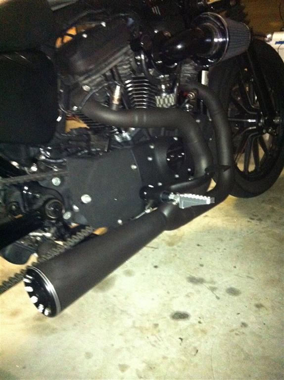

    Good HP & TQ numbers, just has a dip in middle, i would like to see that timed as well. these bikes need it as the rubbers mount frames are heavy compared to early 1993.
    looking up that pipe in Pic looks a bit restrictive, even without that butterfly, but not much you can do as you need to quiten them some. i think the suppertrapp is good that way as you can tune & adjust sound level power & torque level. but i have never tried one with EFI. best pipe i've seen for sportsters was made in Australia 2 into 1 removable baffle light weight. they all used them on the roaring sporty's. but a bit too loud for street unbaffled. daddyracer56 probably still has some.
  • hairymongrel
    hairymongrel
    The patriot pipe is 295 plus 150 postage from hammer.
    The Dan moto is 279 delivered. Big difference that's why I'm interested

     small update 2nd ride today 5klm  all good pulls nice and strong even restricted to 3000rpm  new pipes are much quieter
  • slapster
    slapster
    Great to see it all come together. Pipe looks good, is it loud?
