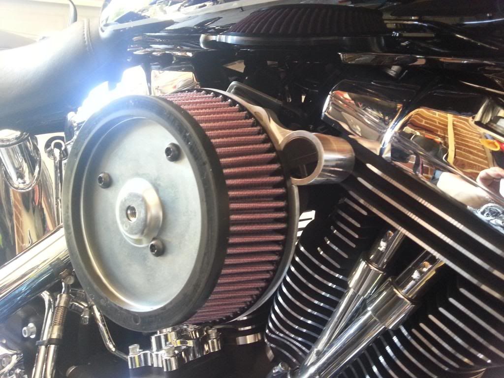

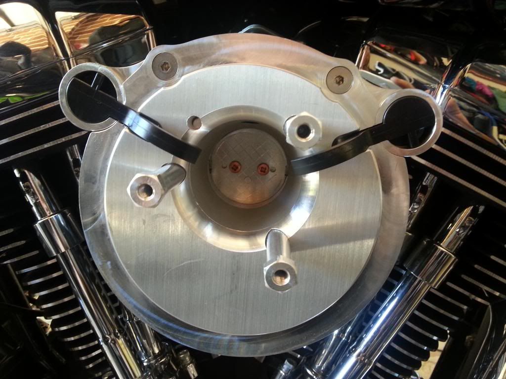

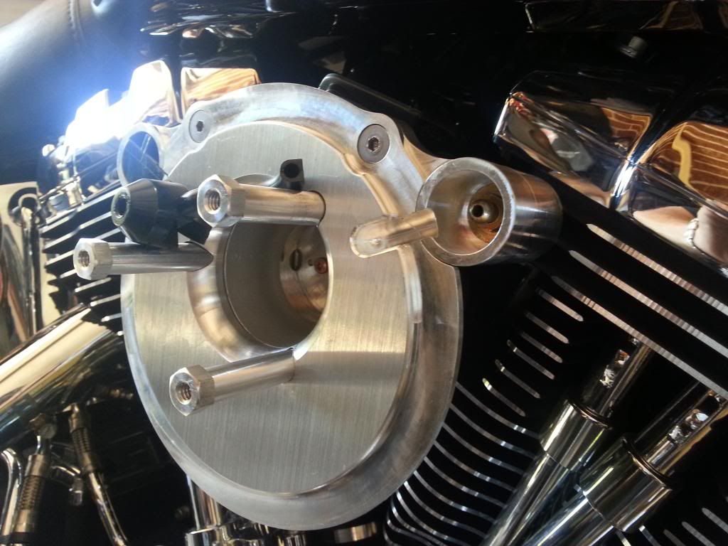

    Got my new PV and Fuel Moto billet air cleaner and installed the AC today on the 2012 FLSTC.

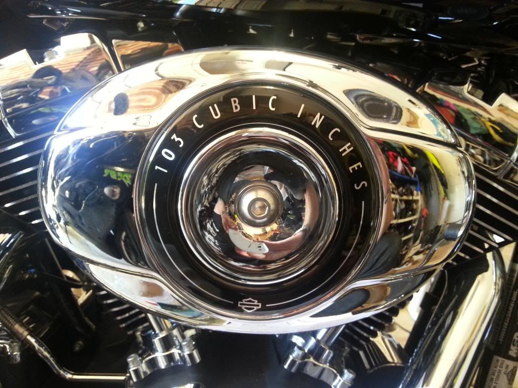

    As I was taking the old AC off, I had to unplug an electrical connection to the intake that looks like it activated a little flap to enlarge intake area. Is this the active AC? There was of course no where to re-install it and I was wondering if this would matter - can't see that it would.

    Nice Alloy
    washable element
    All done and original looking.

    They are 2 separate things. You can disconnect the exhaust actuator and leave the air cleaner wiring connected. If you take off your (standard) air cleaner and backing plate, you will see where the connection is made , and can leave it plugged in. It's a physical connection. Then start the bike and disconnect the exhaust actuator under the rear exhaust.
