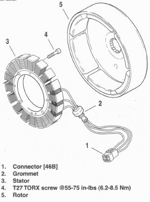

    many thanks to you Daddy Racer for the talcum powder  trick , the true point of origin of the leak showed up straight away . Only problem is that its coming from behind the rubber grommet  that has two wires that go to the stator !!! . Sum Ting Wong             Advice please     Wayne  2000 Duece

    DB, the Stator is in the primary, and that's where the oil is coming from.
    I had the same leak after refitting my motor recently.
    I cleaned around the grommet with a syringe filled with thinners, then used silicone in the syringe to pump it in behind.
    Probably not a permanent fix, but will work until you feel like stripping the primary.

    Thanks for the tips , Ireckon your probably right about the shop price, speedstr ,say I go with silicone method, and it works, what internal damage will be done, the oil shouldn"t be there should it? or is it just being flicked there by the primary or does aseal need replacing or is it just a grommet gone hard .

     The stator is inside your primary, behind the rotor and the compensating sprocket. The primary is obviously part filled with oil. (07 softail in pic)
    The oil is leaking past the Grommet (probably hard). Can't do any harm to use sealer on the outside.
