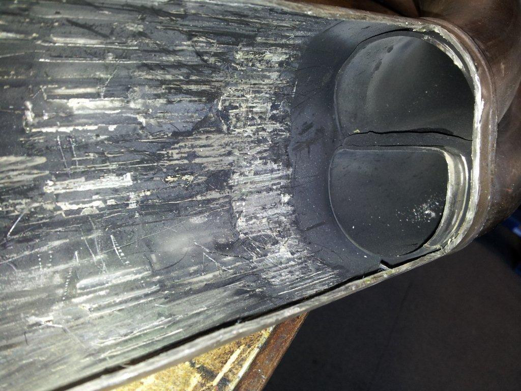

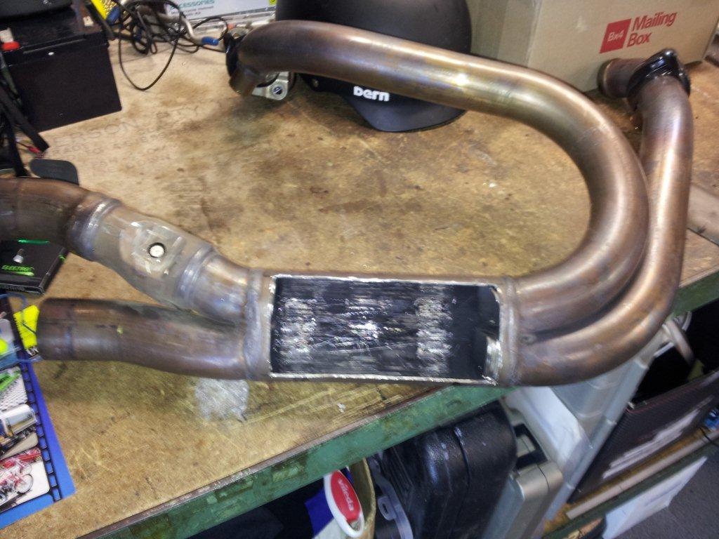

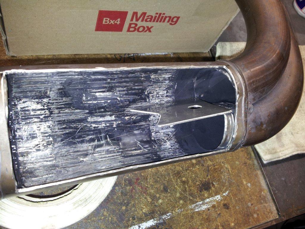

    Im running se 259e cams and stock Tommi gun headers 2 into 1, de catted with a divider and exhaust flap removed, V 7 H slip ons with straight thru baffles.
    So pics attached.
