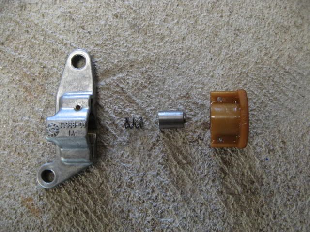

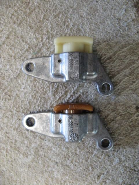

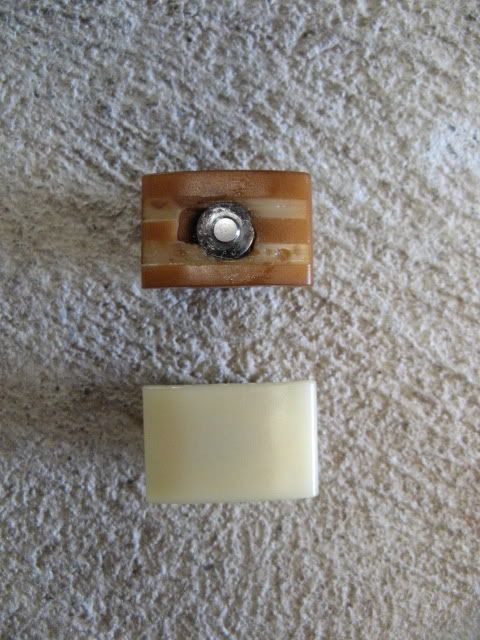

    This was my outer Cam chain tensioner after 20k.  When I put cam in the bike this was what was presented on tearing it down.  The inner one had no wear at all.  Replace the tensioner $64.  Comes complete.  The reason for wearing out was the tensioner was assembled wrong in the factory.  The small spring is supposed to be between the shoe and the plunger.  This one was as is laid out.  So excess pressure on the shoe against the chain.  When I got the new one I showed the spare parts guy and he was surprised.  In the end it is an easy job checking if you have the exhaust off.  Peace of mind in the end.  If I hadn't decided to check then it would have eventually worn all the way through and the pin would have entered the chain and cabang..  Major failure
