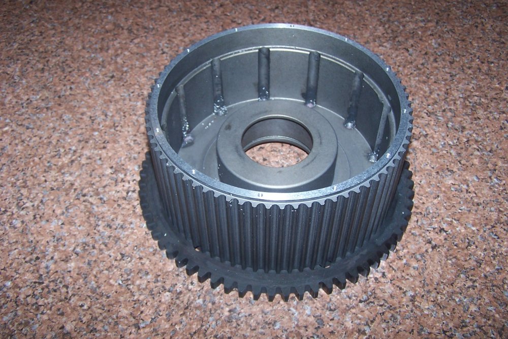

    had done just under 800ks, parked it and, bike rolled of its kickstand, first part to hit the concrete was the flange on my brand new clutch basket.
    Broke of part of the basket flange, Yea I muttered a few words but what do I do now!
    I stripped the primary and had a busted ass clutch basket, pictured lookin at me.

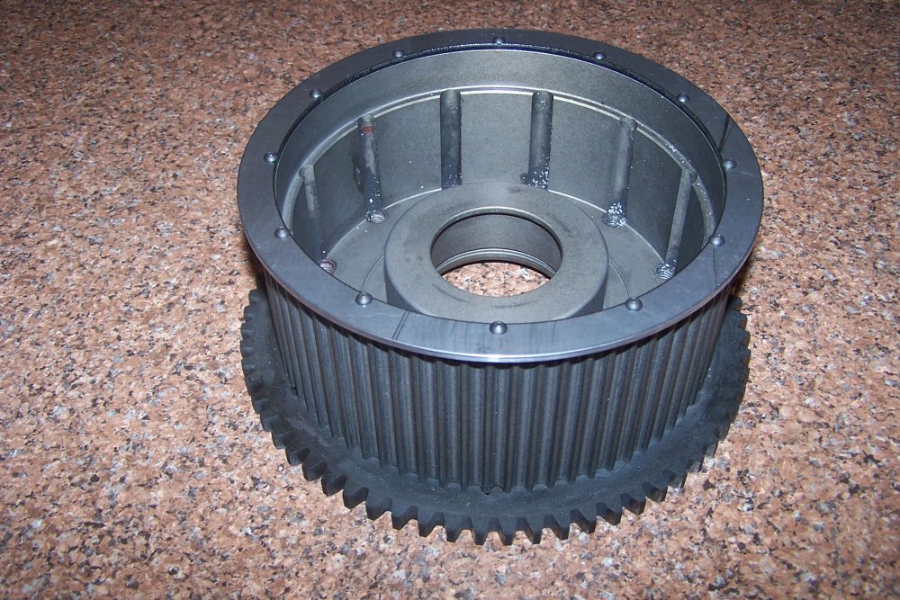

    Machined off the old flange and had had some new flanges Laser cut from 3mm mild steel, drilled and tapped the old basket.
    Screwed on the new flange with 12 off  M3 x 8MM Button head cap screws.

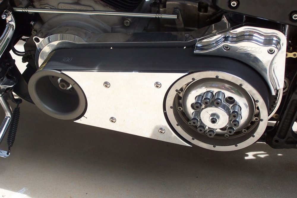

    And reassembled.
    Went for a ride, all works well.

    Thats a great repair. Even looks like it was meant to be there.
    Regards
  • Burnzi
    Burnzi
    Well done, nice job and good before and after shots
