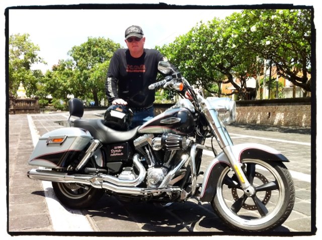

     Fitted the Cobra along with SE air, Bassani 2/1, Woods 222 cams...pulls like a 16yo schoolboy on the net, right from 2000 to 5500 rpm...effing wicked!!!
    Running Cobra settings of 1,10,9
    Anybody else got Cobra experince as I still have some small surigng at 2 - 2500 rpm...if I cant fix it I wont worry to much but there is a lot of heavy traffic riding here at low rpm
