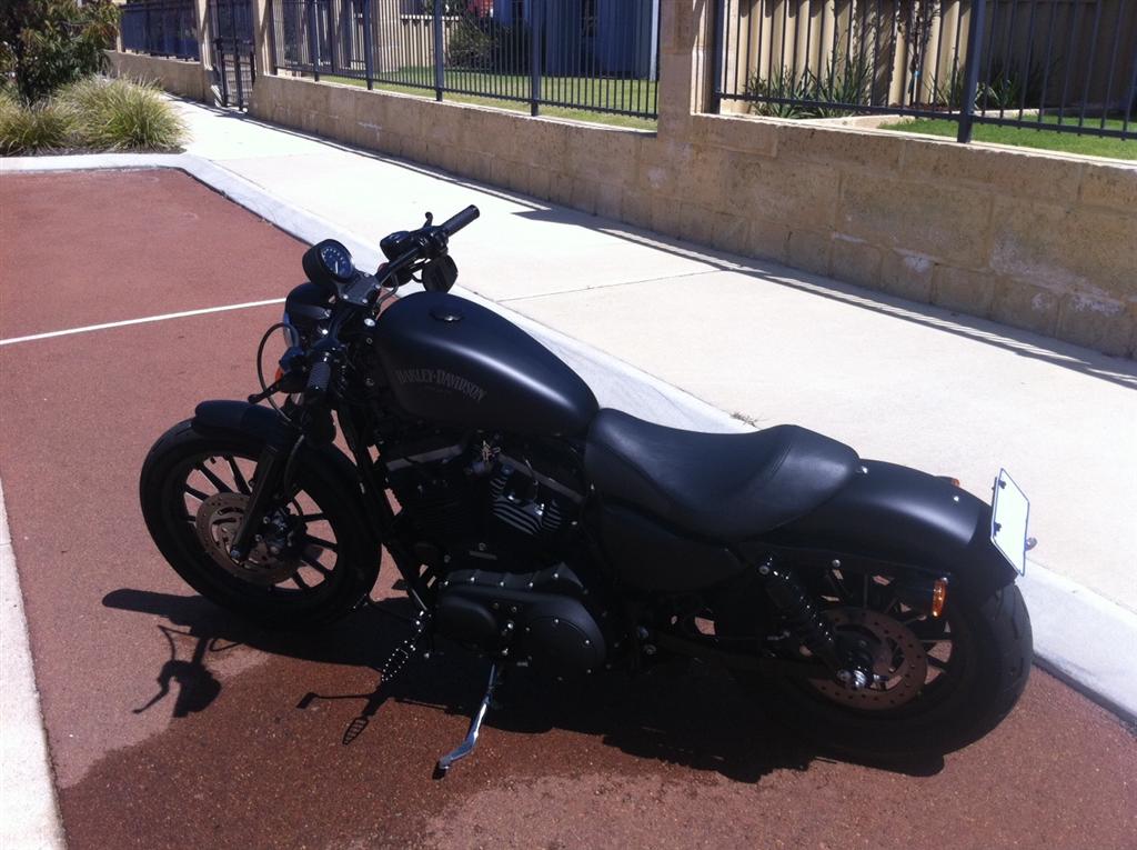

    After months of looking at other people bikes and asking everyone’s advice I thought I would through up some pictures of my Iron.
    Mods to date are
    • Vance and Hines short shots
    • Roland Sands air cleaner (impulse bye form dealer, very nice but could have done better with the $400)
    • SE race tuner
    • Progressive rear shocks and front springs
    • Wrinkle black inspection covers
    • HD shortened rear indicator/brake light stems
    • Number plate mounted to rear fender
    • Joker Machine fuel cap
    • HD forward controls with Roland Sands Moto foot pegs and Joker Machine road racing shift peg
    • Flanders drag bars with internal wiring
    • Arlen Ness grips
    • Custom Chrome levers
    • HD L.E.D. head
    Still to come
    • Speedo relocation
    • Bobber style head light mounted on the triple tree
    • Bobber style seat
    • HD XR front brake calliper
    • 1250 engine upgrade

     Very nice mate, like the mods.
    well done, do you have details about the short stems used for tail lights?
    i have been thinking about shortening mine.
    is the plate bracket off the shelf?

    Looks good mate.
    Smoked front lenses are a cheap easy mod as well.
    Which speedo relo you lookin at?

    Hey Johno I order them from Harley I think they are off a soft tail the part number is 69933-08. You need at 650mm bolt to secure them. Had to unbolt the rear suspension to get them in, worth it though the others stick out to far.
    Hey Slap think of going with the autometer bracket and painting it black, value for money!
  • slapster
    slapster
    I've got a new unused black autometer bracket kit from ebay. Lookin at the RSD kit now so won't be using it. Can save you some postage, PM me if u want, I'm NOR.
    Slap.
  • darkdesign
    darkdesign
    have a look at dk customs for alternatives too, kind of halfway between the joker & the autometer.
