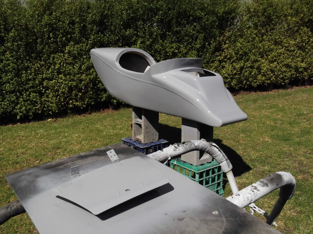

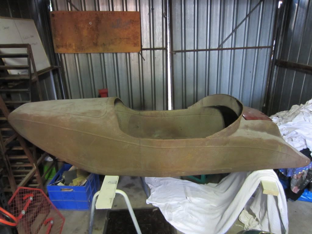

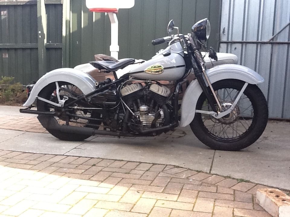

    The sidecar is an old Goulding that I bought from a friend. Here's how it looked when I bought it.
    And here how it looks now
    It pulls the chair pretty well and is great fun to ride. I dropped the engine sprocket down a few teeth and it will sit on 45mph all day long. In saying that I got a bit of work done on the top end when I had it apart. Things like shaving the heads and relieving some of the metal between the cylinder and the valves. This gives it a bit more punch.

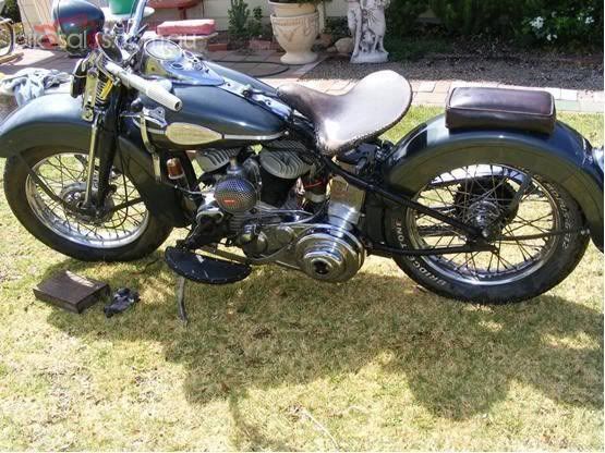

    Got any pics of your WLA

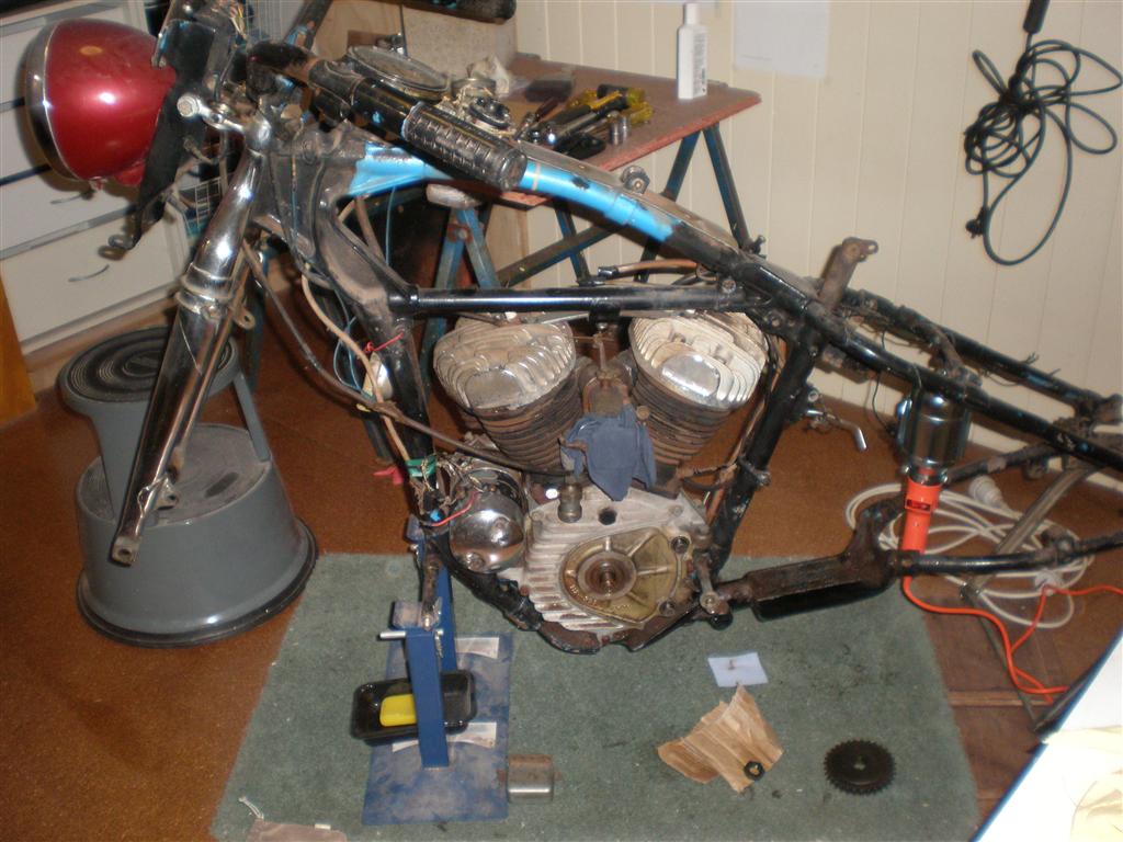

    Thanks alot for that Rod l am more in the know about my bike now . l have another thing that troubles me .. actually l have many ... but one at a time is best . The frame neck cups on my 1943 WLA  are in need of replacing  and l am unsure of how to remove them . l would be grateful for any expertise on how to do this . Regards Greg

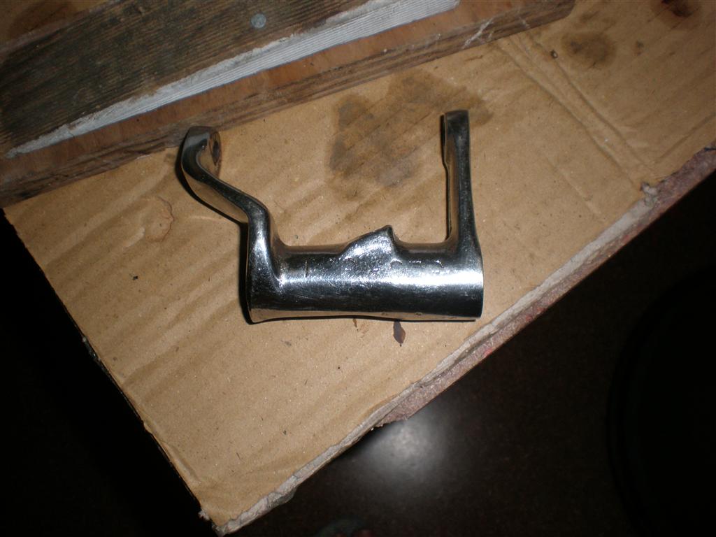

    Hi Greg, I have just done this on my frame last week, quite simple really. They are just a press fit into the frame , as you can see on the frame, the cups are much wider than the head stock,all you need to do is use a hammer and punch hitting on the outer part of the race housing, one hit on one side then one hit on the other , keep doing this until the race cup falls out of the frame, these can be very tight in the frame as they may have been there for a year or 70 , to insert the new cups , place them into position , use a hammer with a piece of wood on the cup race and gentle tap back into place until the race is fully seated in the neck.

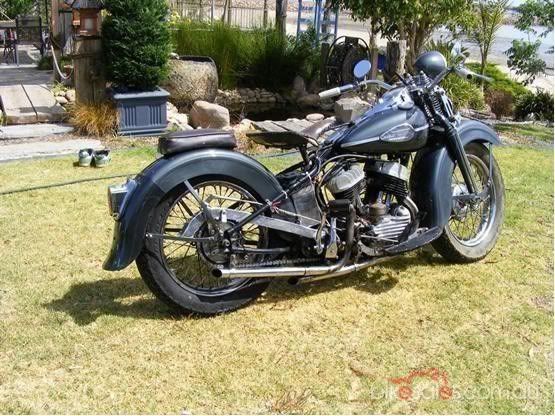

    Dave nice look bike . A Side car on a WLA's is fun , I have one , few mods to the motor and a 31 tooth engine sprocket she's no power house but purrrs along at 50 mph

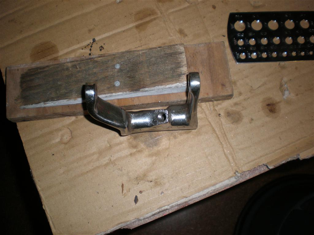

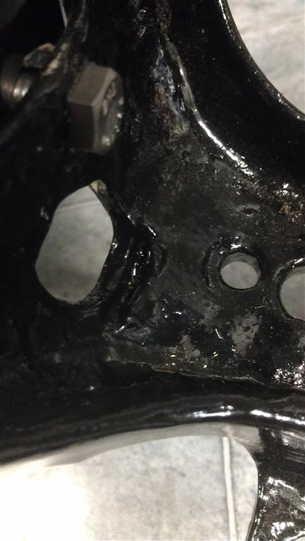

    A Head stem bearing cup removed from the frame , as you can see just a press fit into the frame.
