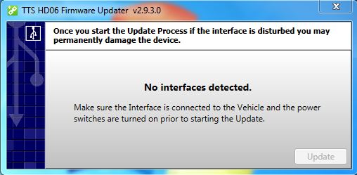

    Hey guys, downloaded, installed and updated the TTS software from their website. Following a guide from the american forum I plugged the interface into the USB port on my laptop then plugged the cable into the bike. Ran the 'HD06 Firmware Updater' and it came back with the following...
    Thinking it might be a Windows 7 issue I tried on an XP laptop with the same result.
    Any ideas?

    Yeah did that mate, sorry should've mentioned that. Reinstalled drivers as well, checked USB ports.
    Guess ill check this http://www.mastertune.net/usb.htm
  • Deadwood
    Deadwood
    Nah, black
  • Steve Cole
    Steve Cole
    Updated software was released last night. This new update contains all the NEW Analog features and some of the necessary updates for the next generation of tuning that's coming.
