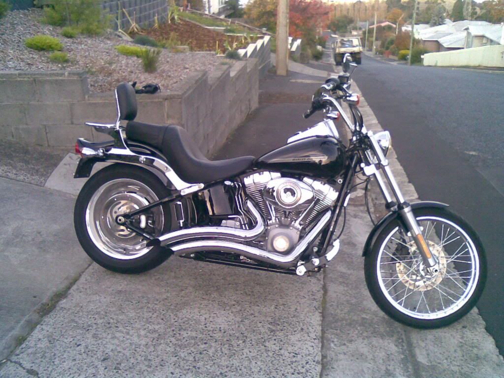

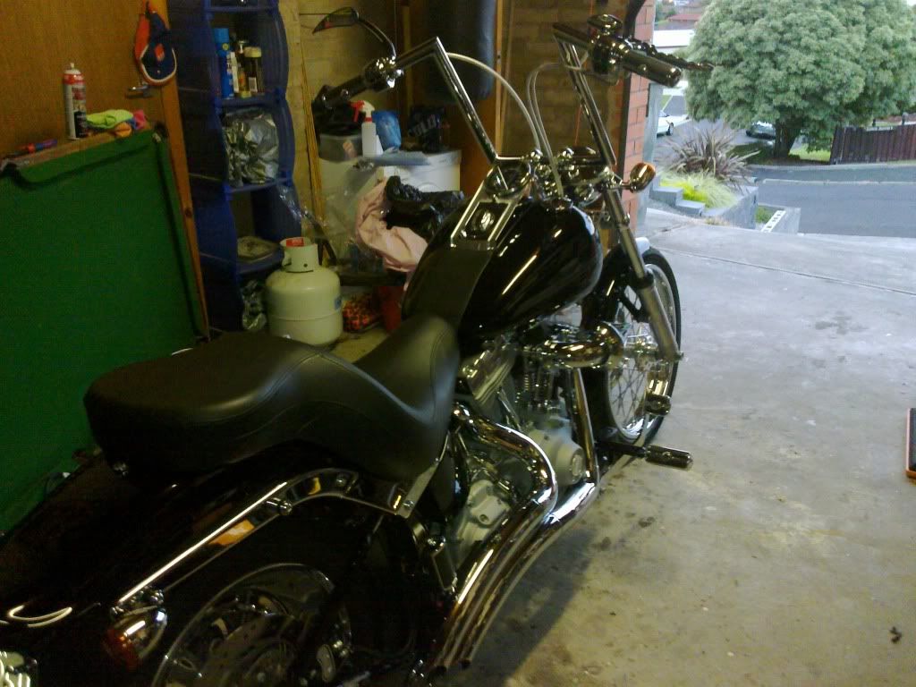

  • -MaCCa-
    -MaCCa-
    Here is my bike with 12" mini apes with 2" risers. Stock cables.
    Not a fatty, but you would think cabling would be similar???
    I now have 16" bars, sloped with the forks. They are great.
    I hope I have added the pictures OK, admin feel free to fix it, if required.
  • the_mongrel
    the_mongrel
    Thanks man - That looks cool! I like those bars!! :)
