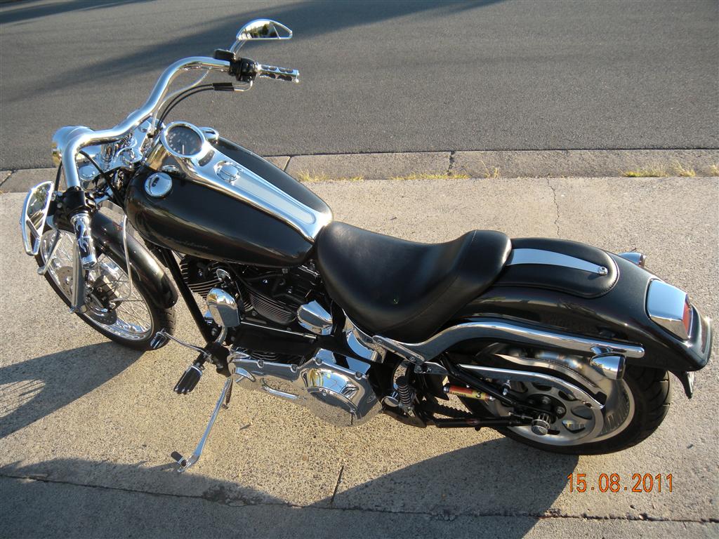

    Mate I know its not a FX but on My softy they are great. Best photos i have are below. Just watch the width if you worried about those that like to fleese the public.

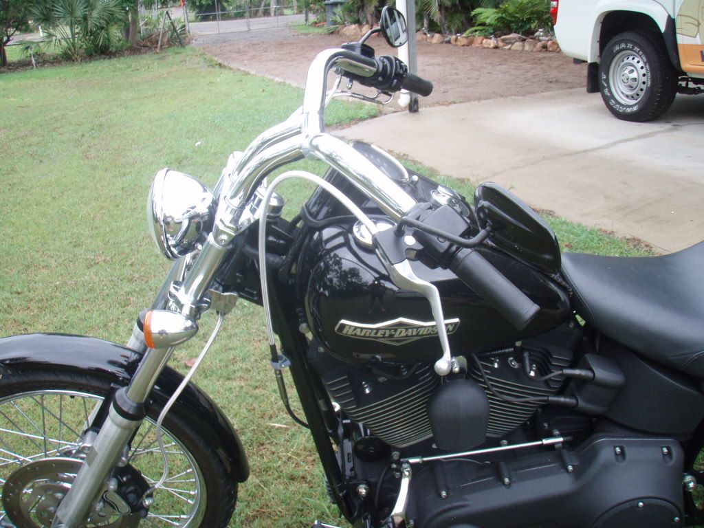

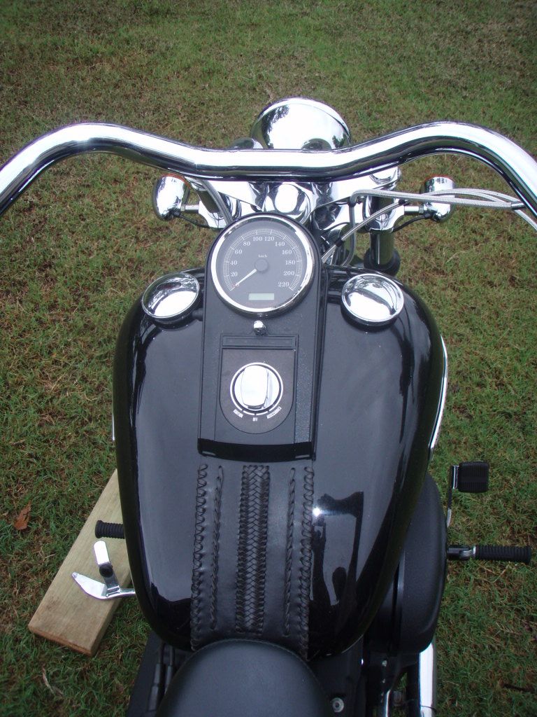

    i put westerns on my heritage.they seemed to pull me to far forward with the stock risers so i fitted deluxe risers which liftted them up about 50mm and back.   the top of the risers come very close to hitting the speedo couling,2mm gap on full lock but doesnt really present any problem. still looks low and cool.these bars are wide so just check stretch when doing full lock manouvers (parking etc).very comfy in wrist posy .

    Thanks mate, Nice ride

    Looks good, nice bike.Yeah....ive heard they frown upon them being too wide.
