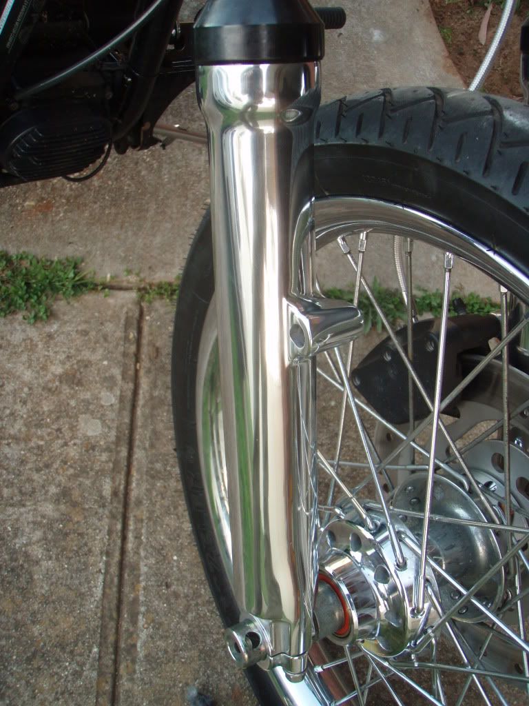

    elbow grease...
    before
    then add
    to get
    SHINY....
  • dodge
    dodge
    Sensational results Russ!

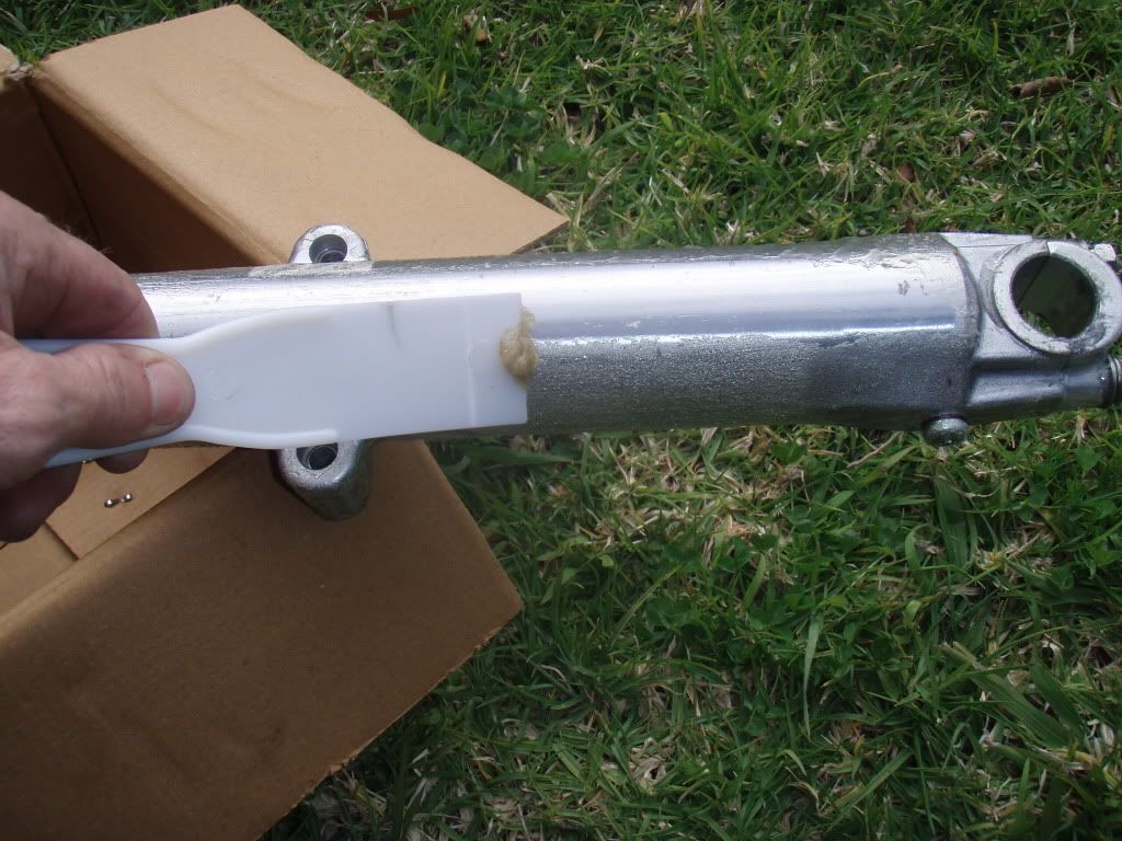

    2. Researched strippers to ensure that I didn't get blackened alloy. Worked out that anything that is not caustic based should be ok. The Poly Stripper is "dichloromethane" based and proved effective. I tried on a small area first to ensure that it wouldn't attack the alloy

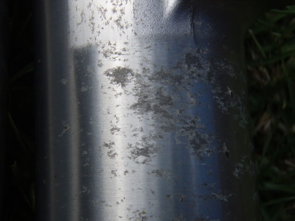

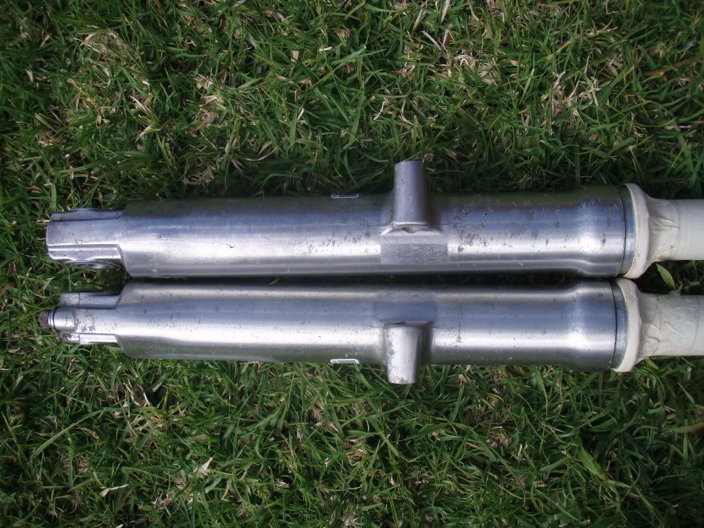

    3. Applied it to one fork at a time and it took only two minutes to remove the clear.

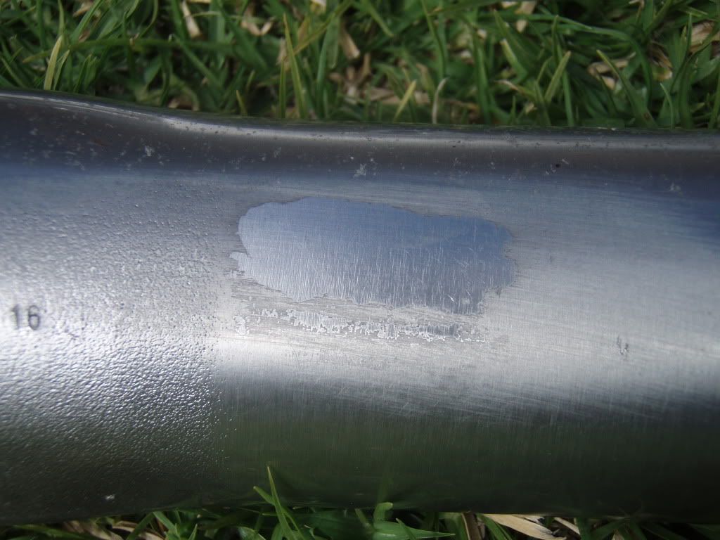

    4. Then came the fun bit. (I smell sarcasm). Sat on the lawn with a bucket of warm soapy water and the roll of 400 grit emery. I really wanted to get all the cast marks out of the surface to give them a better appearance. When you get into the radiused bits wrap the emery around a piece of wooden dowl, that really helps. Get two or three different diameter bits to suit your forks and away you go.
    5. I tried all the abrasives in the photo to see what worked the best and I would recomend the emery for only $11.50 from Bunnings for a 5 M roll. All the rest worked well but the Emery was the winner hands down. Finised off with a quick rub with 800 grit. Time per fork was three Hrs approx. Warm sunny day some beers and really the time flies by.
    6. Then I took them to work and used soft buff and white rouge to take the final sanding marks out and complete of the finish. Time per fork 30 Mins max as I did them both in my lunch break.
    7. Buff wheels really take the time out of polishing and I would not have got anywhere as good a result without one.
