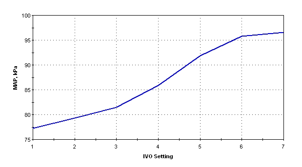

    Cam tune
    Map Kpa of Cam tune notice its at around 50?
    Map Kpa when Vtuning at around 40? which i believe is correct should this be different fromt he Cam one, or did the shop do some work to my ride and then deny it? (dont know if thats right just asking?)

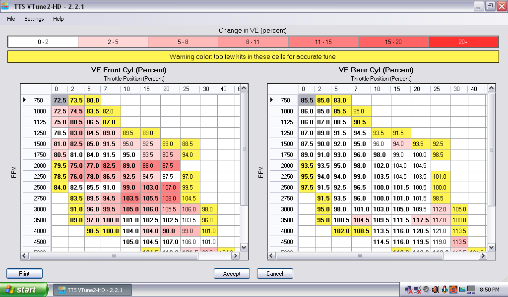

    Second run graph (first one was just idling in my car port)

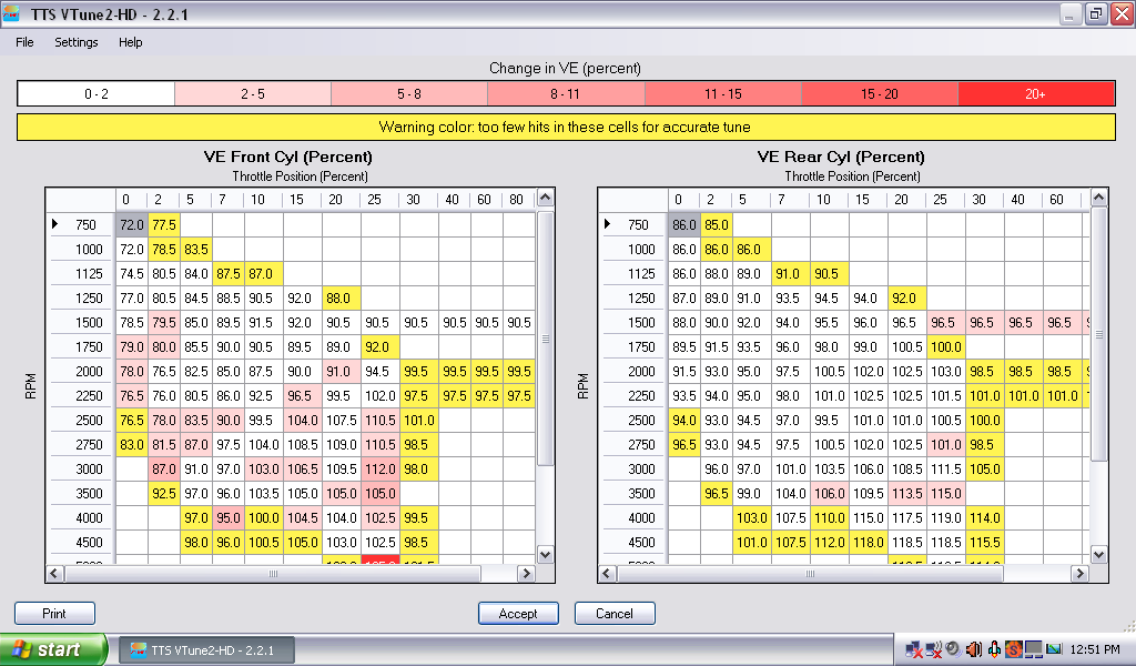

    Vtuned graph after blend - note i didnt extend the map when blending (check out that rear cylinder?? wtf)
    I did a second run after this but it locked up half way (well maybe a thrid of the way but i did get some data).

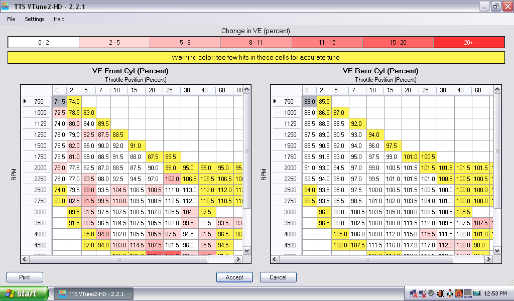

    Here is my two vtune blends first one is not extended the second is.

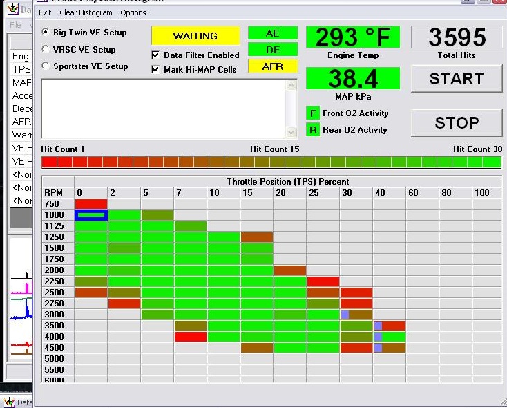

    Well did some more tuning today,
    Not sure about what he reckons going back on tuesday to get them to put syn oil in and then we will settle the bill (and get the story), either way I think its not going to go well either i paid for the heavy breather and they where in wrong? or its still got issues? hes going to pull the crank plug before he does the oil I will compression test it myself when I get it back on Wednesday after work.
     He is my next few tuning graphs, still some work to do, all auto extended.
  • KiwiRob
    KiwiRob
     There's something going on I think with the front cylinder VE. Intake leak maybe???? - Rob
