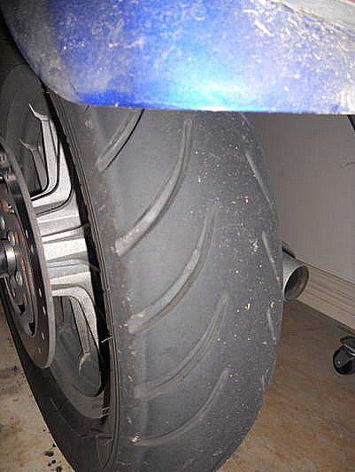

    I put Avon Venoms on my 07 a couple of months ago to replace the HD Dunlops, recommended by the specialist bike tyre shop I've bought my tyres from for over 20 years. They handle extremely well wet and dry and have a nice round profile which lightens the handling a bit. I've only put about 3000km on them so far - well over half that on wet roads - but the wear appears negligible. (My other bikes usually wear out a rear in about 6000km due to the stone chip roads around here.) If you do get them make sure the tread is well and truly cleaned and dry before you ride off - they have an incredibly slippery residue on them - and take it careful until they are properly scrubbed in. Definitely the slickest new tyres I've ever ridden. I stuck the bike on the lift and spun the tyres against an emery paper pad until the crud was off, then gave them a quick wash with soapy water. The original HD Dunlops are pretty good as long as you don't leave them on forever. They don't appear to ever wear out - mine had 14,000km on them and looked barely worn but they were as hard as rock and had no wet grip. The bike had 10,000km on it when I bought it in May and the tyres were the originals. They do handle surprisingly well and the rear had perhaps 1/4" of chicken strip on it when I changed them out, but I'd make sure they were changed every 3 years or so regardless of the depth of the remaining tread. The Venoms turned out to be cheaper than the HD Dunlop set too. Rear was a couple of dollars more expensive but the front was about $40 cheaper.
  • scrivens
    scrivens

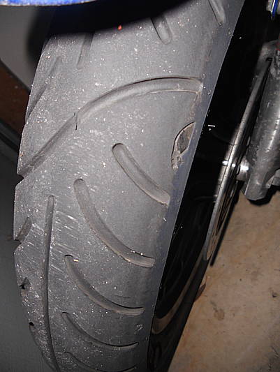

     Couple of pics at 3200km:
     Good deep tread and rounded profile. The strip on the edge is about 1/2" wide.
    That's the Venom snake-head logo on the edge, and a moulding tag in the middle of the tread channel.
