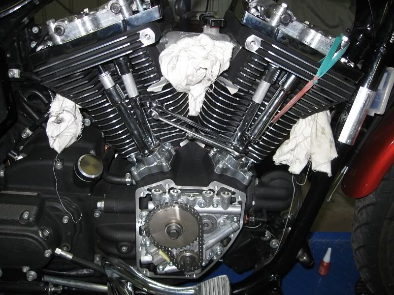

    Anyway, I've done 100kms, and it's had the first oil change.
    Running very strong (only been up to 3500 Rpm and small throttle openings), front cylinder is a little warm, but still running in I guess. Appears to have decent oil pressure, and the valve train is pretty quiet so far for the Wood's TW8 Cam.  AFR is floating around 14:1 cruise, and drops into the 13's under power. I've advanced the timing, but needs still needs more work.
    Will try and get around 500kms up, and will look into some Dyno time.
    The clutch adjustment was a bit weird initially with the Barnett extra plate, running out of lever, but is settling in now, and lever pull is strangely light with the SE spring. Not sure if it will hold though ?

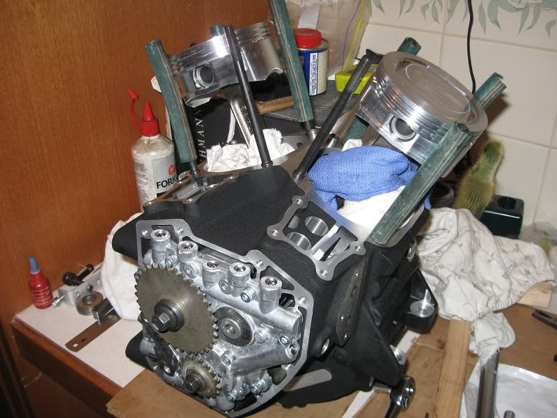

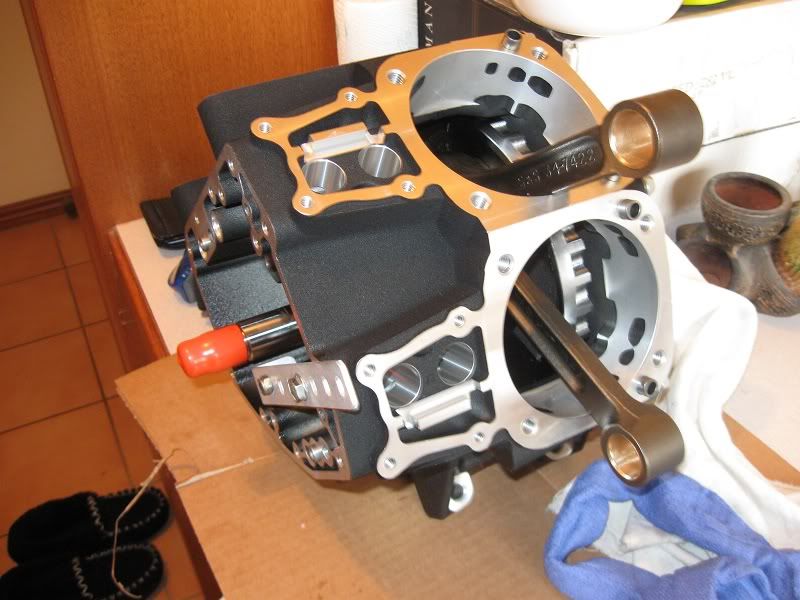

    Looks like the new motor has gone tits up !!
    Found the rod big end side clearance is screwed, 1.35mm clearance, and the crap in the oil has scuffed the bore/pistons.
    Was still running great, and pretty quiet !
  • Ando
    Ando
    Fuck mate I feel for ya
  • speedzter
    speedzter
    The worst thing is, I have no F'ing idea why it's happened !
    I'm trying to figure out if it's anything I could have done wrong ?
    Figured I was doing the right thing by having the Crank built by the best, and having them set it up in the new cases.
    I'm sure they will stand behind their product, but it will still cost me $$ and time.
  • speedzter
    speedzter
    Badcooky, not sure what your point is ?
    That was my experience when fitting the clips, and the piston pins were free before the motor was assembled.
  • speedzter
    speedzter
    The pins were free to move and rotate once the clips were fully seated.
    No interference fit whatsoever.
    It was never assembled with tight pins.
  • speedzter
    speedzter
    It appears the rear rod big end has been grinding away on the flywheel.
    It should have something like .005 - .020" side play, and now has over .050" .
    The pistons/bores aren't badly damaged , as it's only done around 300km's
    No obvious metal in the oil as such, just a black film in the oil.
