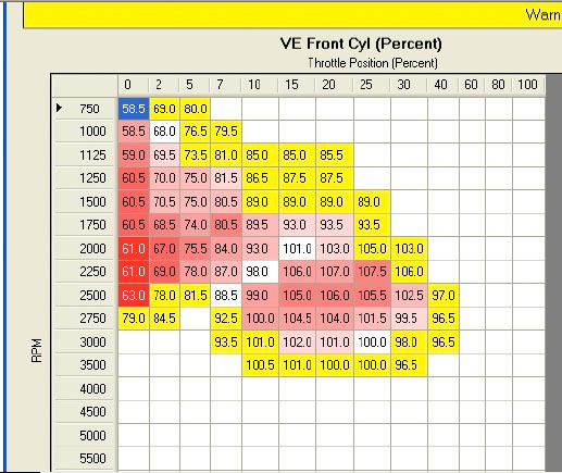

     Ok boys I just got back from a vtune sessions - Hmmm!!!
    I did two runs.  First one was about 30 minutes long, and the second about 20.  I don't know if I got enough data.
    Also - I have attached a couple pics because I am a bit confused.  You can see the the image with all the white blank squares - that is the print out.  But when I go to actually extend the rows as per the manual, they are all full!!  WTF??
    Anyways... I will do another run again during the week and try again.
  • Ando
    Ando
    Ye mate looks like your onto it
    what it says is ya have a big percentage differences between data gathered and original map
    idea is to get the percentage changes to a minimal and then you have your VE'S set
    few more runs yet

     Well... I am just back after dropping in a Map that Hilly "massaged" for me and I can tell you it made a HUGE difference.
    Basically it is a blended map of my first 2 V-Tunes and the throttle response is awesome!  I was always cautious when say going around a roundabout as the bike would be twitchy!!   As in - from zero throttle to a little bit of throttle was jerky.  So I would feather the clutch!!  No more!!  The throttle response is now SO smooth, it feels like a different bike.
