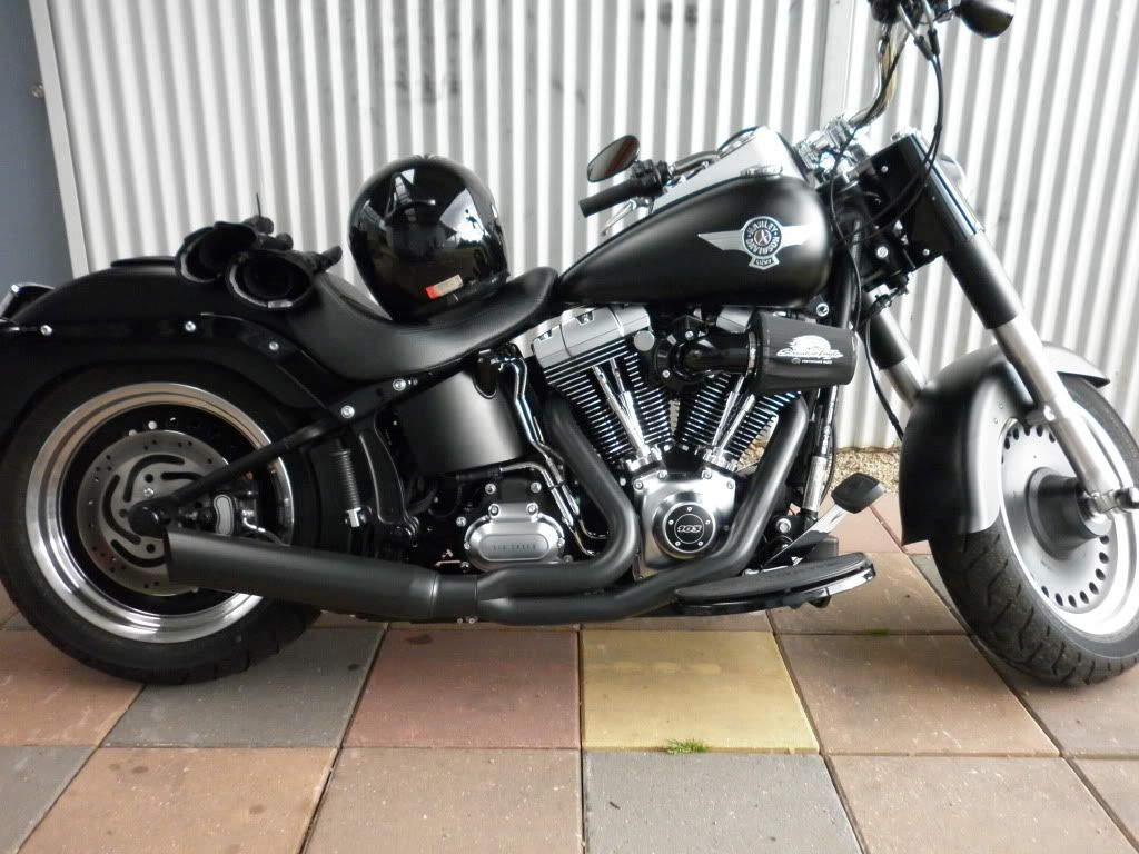

    Hey guys, just wondering, whats the best way to clean denim black? Any and all suggestions appreciated.

    What Harley says
    Cleaning Black Denim paint:
    ? For heavy deposits on finish:Use a grease cutting dishwashing detergent and a clean H-D wash-mitt (P/N 94760-99). Dilute dishwashing detergent per instructions provided by manufacturer and rinse thoroughly with clean water.
    ? For light deposits on finish: Use ammonia based glass cleaner and a soft H-D Soft-Cloth (HD-94656-98).
    ? For final detailing: Use H-D Gloss with H-D Soft Cloth.

    wash it like you do the car. and for day to day cleaning use windex.

    windex

    windex and mr sheen for polish.

    I'd use Mr Sheen for chrome but wouldnt polish the paint at all, just wash it and wipe it over with a towel.

    Thanks alot guys, I used windex on the paint and it worked an absolute treat! I use "purple" silver polish for my chrome which I find is the absolute tits when it comes to shining up the bling, if I can give one bit of advice as a HD newcomer it's go grab some of that shit. Its the best metal polish I've used. http://www.californiacustom.com/purple_metal_polish.html

    silicon tyre shine on black engine, primary, tranny cases
    brings them up treat and the bugs dont bake on to them either
    and yeah, don't polish the denim paint at all or it won't stay denim

    Yeah I don't use anything for polish, cheers for the tip on the black engine trim cleaning!
