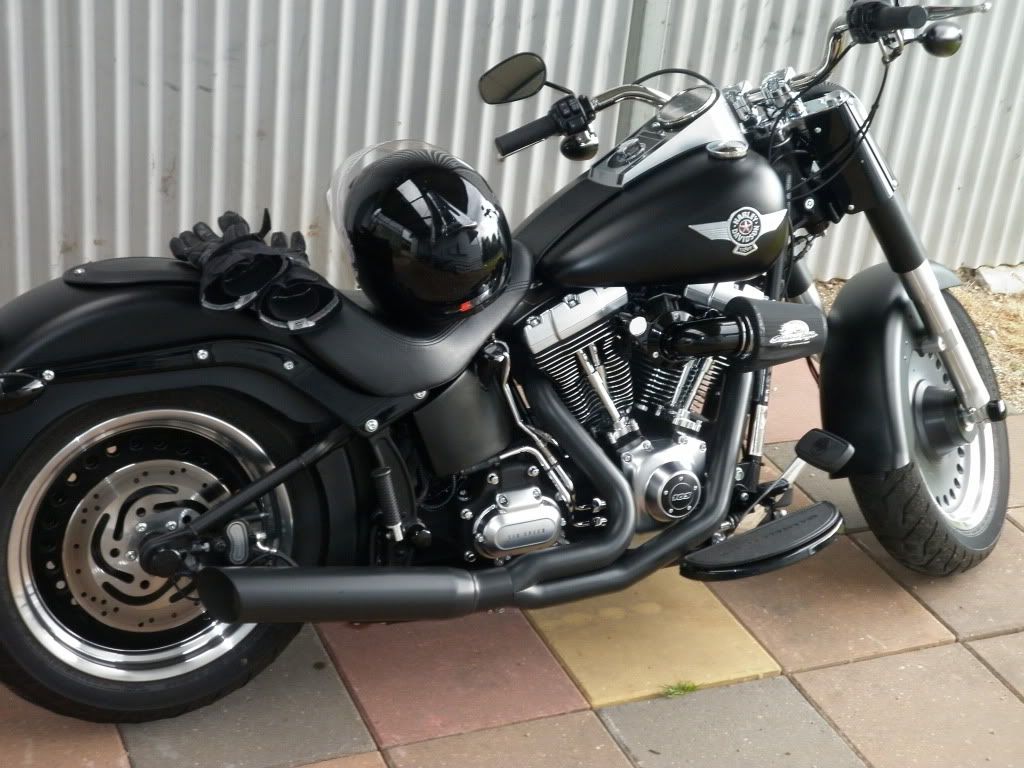

    Hi there i have to get new tyre so i have to remove back wheel it looks like i might have to take caliper off could any one tell me any tips would be great thanks.its a 2012 fatboy lo

    I have the same pipe on me bike, you may have to remove the muffler to get into the 2 x (T30 torqx) bolts for your calipers.
