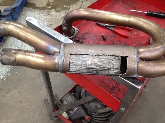

    Switchback stock exhaust below
     Fatbob headers below

    QUESTION ?
    IF u cut out the cat-converter in the pipe/muffler on a newer model like a 2012 model which has the fuel injection etc, does it use MORE or LESS fuel, and does the bike have a oxygen sensor assosciated with the pipes ?
    I am thinking that the lack of back pressure might cause issues after removing the cat, would that mean a automatic retune/remapping of the bikes ECU ?
    OR is it totally different to a car which does have hassles after removing the cat converter/oxygen sensor hassles etc ????
    How did those pipes perform/sound after u cut out that cat (I am assuming thats why u cut open the muffler box) ???????
  • Sponge Boy
    Sponge Boy
     I didn't cut out the cat; that was just a picture I found on the internet to show how stupid the exhaust system is.
    My whole point is; if you want your bike to sound like a Harley you need to change the headers all together. This is what your dealer should tell you.
    As for cutting out the cat; from what I've read, it only improves performance and economy. The CO2 sensors are in front of the cat and, therefore the removal of the cat doesn't affect engine computer. As far as I've read, as long as you don't change the intake system you don't need to re-map it.

    QUESTION ?
    Once the cat is cut from the headers you get cross talk between the 02 sensors. Best to buy new headers and keep the stockers in case you get a canary to front the EPA.
