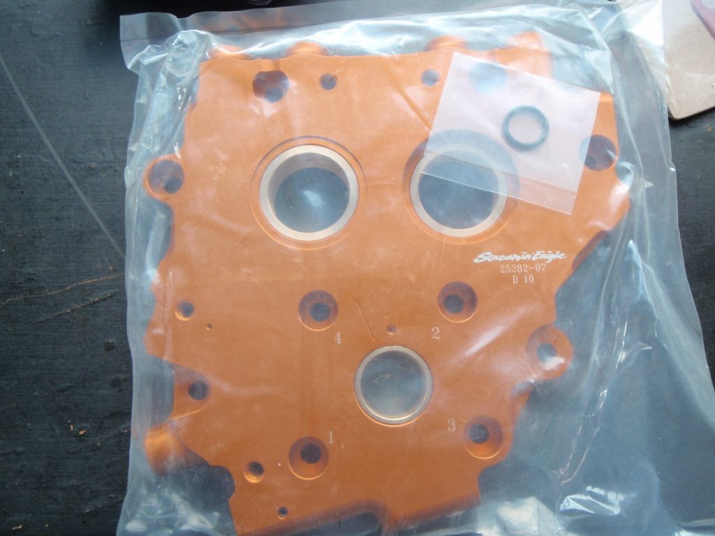

    SE cam plate

    I got the 2011 120R that didn't come with the SE cam plate but the SE compensator, 2012 120R's come with the cam plate and not the Compensator
