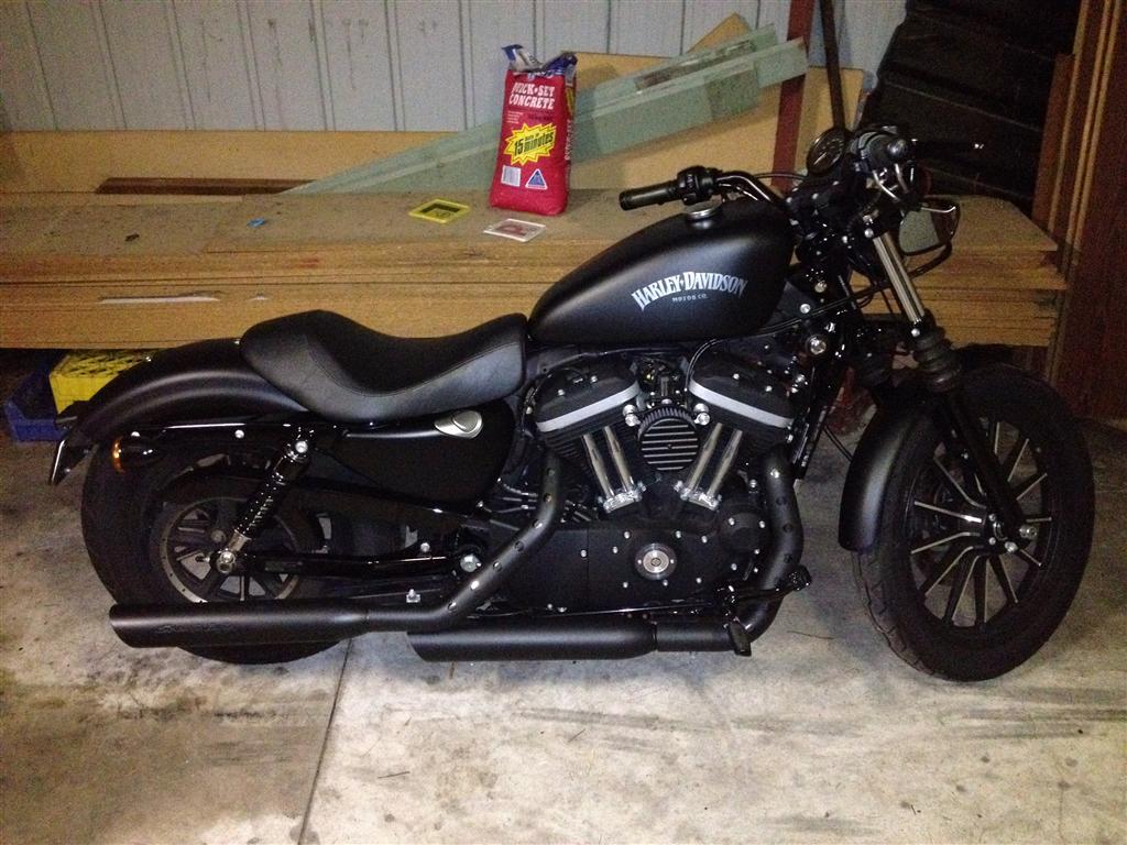

    Now how bout a pic of that new intake...
    Slap.

    Slapster
    As requested here is a pic of the new filter
  • slapster
    slapster
    Oh yeah, nice, I looked at that one a while back. Similar to the Joker intake.
