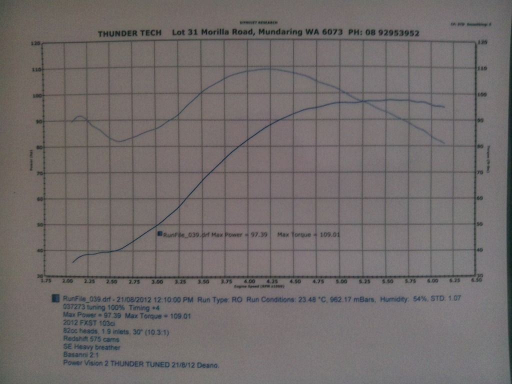

    Just for interest sake I put some Redshift 575 cams in a mates 103 softail on the weekend, I had manely valves with a 1.9 intake fitted, decked heads to 82cc and decomps drilled ( no port work)
    with the head work (including buying secondhand heads) picking up the cams secondhand, adjustable pushrods, gaskets and us doing the build took us about 6hrs this build cost under $1500
    it was dynoed today and made 109 torque and 97hp this is on a conservative dyno using the powervison This is pretty close if not on par to some of the $5000 stage IV kits
    I road this thing without the tune and it is a tyre shredder. this is just the sort of thing that can be done with out spending big money and my mate absolutley loves the ride and enjoyed doing the work
