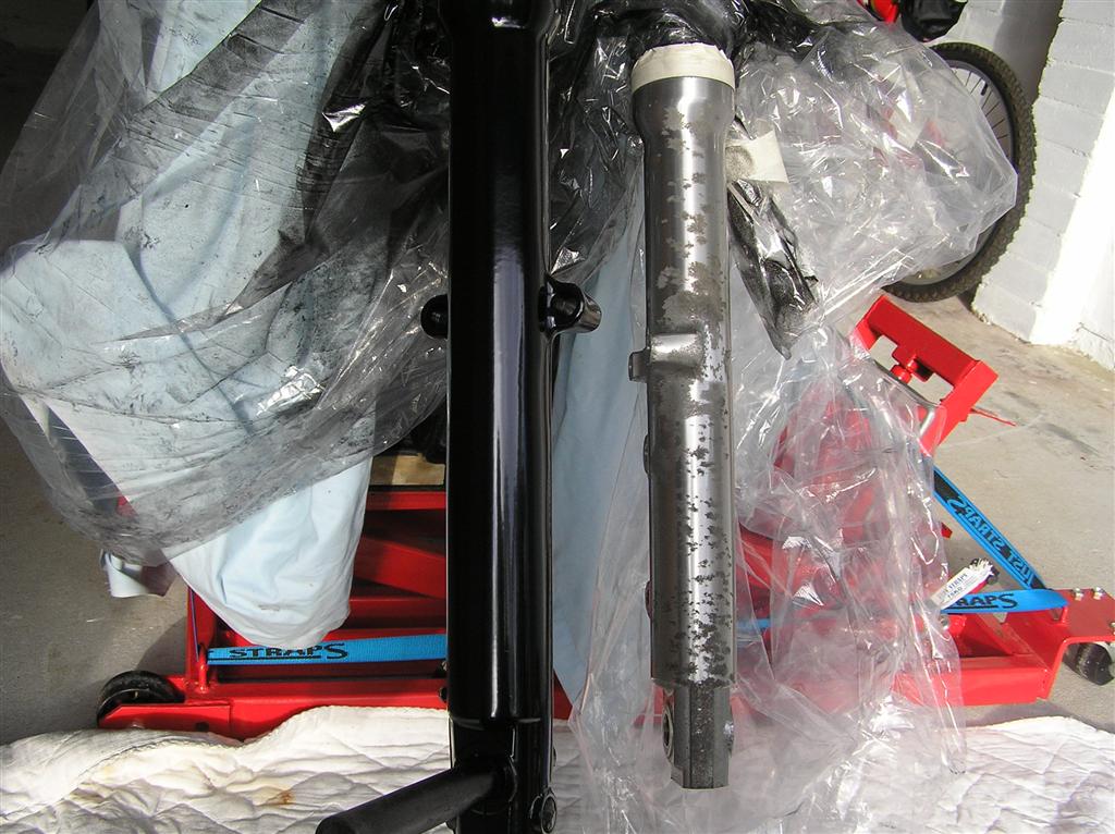

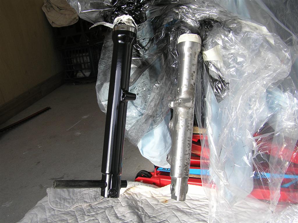

     Decided I wanted black fork legs in order to tidy up the bad pitting on the alloy/clear coated factory supplied units.
    The forks are on a 95 sporty ( so they have seen 17 years of stone chips etc) and looked awful. You can see on the side by side pictures what a difference it made by spraying.

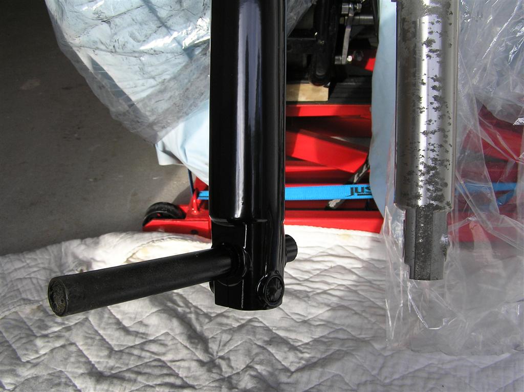

    I sanded with 400 then 600 grit, cleaned then off and then sprayed with PPC Blackcoat. Note that I found it best to do one at a time. Also see the piece of metal I used as a handle in order to rotate the leg as I sprayed to get an even coat. Two coats used. Remember to cover the bike well and tape up all the critical holes.
    Dave.

    No. It is not an epoxy. It comes from a company called Permanent Painted Coatings. Look up PPC on the web and you will see all the products. They specialise in finishes for doing up cars etc. I spoke to them and this product was the best all round for painting stuff on my sporty. The Blackcoat comes in a spray can and is easy to use. Check them out. Note the stuff is expensive at about $46 per can.

    ha, nice job, did the same thing on my sporty, but used Duplicolor from repco. 3 coats of gloss black, and then 2 coats of clear, still there looking 'factory' a year later. Prob is, it's so simple to do, you start thinking 'maybe this bit should be black too...."
