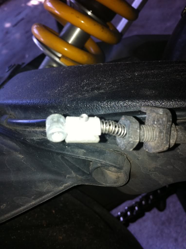

    here is a picture of my "cheap and nasty" fix
    easier to explain what i did. this is not a harley but the principle is the same.
    put a small spring at end of cable to trick the ecu that the flap was still working . i had to use a small cable clamp to get the tension correct with the spring that i used. you can see it in the picture .
    this is by far the easist way to fix without tripping the error code on modern bikes.
