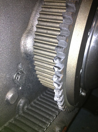

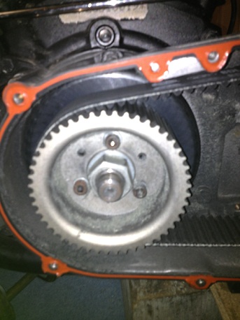

    Hey guys,this is my belt drive. I could hear a rubbing noise with the clutch out then it go's away pulled in. Thought id have a look.
    Is this normal or can i align the pulleys to stop this? Also theres teeth broken from ring gear,dont think this is a real old setup......

     what year bike is that and is that a aftermarket belt kit?
  • 82punisher
    82punisher

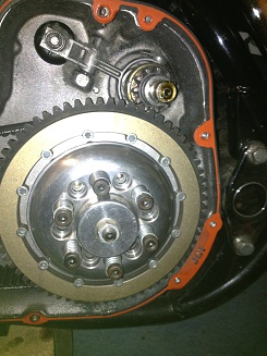

     Hey mate. It's an 82 fxr with a late model evo,5 speed box. The belt drive is an aftermarket BDL kit.
    New clutch setup as well. Cheers

  • Krash Kinkade
    Krash Kinkade
    think the 82 still had the old style hub type clutch? or is it useing a splined clutch?
    if its the hub they move back & forward a bit when you pull clutch in, there was a product called a ram jet that restricted the movement. you need to check alinement with your front pully, thats not right.
  • 82punisher
    82punisher
    Krash,I'm not sure what type of clutch it is? I was told the clutch and BDL setup is less than 6/12 months old and rarely ridden before I bought the bike.
    Ozrodder,I was told by a mate that I would have to check the alignment as well. Everything looks like new and I've only put about 1000 k's on bike since I've had it. I did take out 3 clutch bolts and springs so it wasn't as hard to pull lever in.
