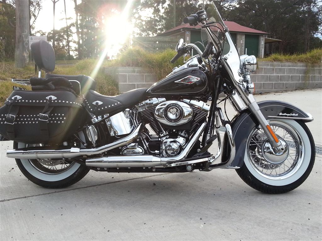

    2012 street glide
     Nice looking bike there Paulybronco, Love the Reds on the Harley's.
