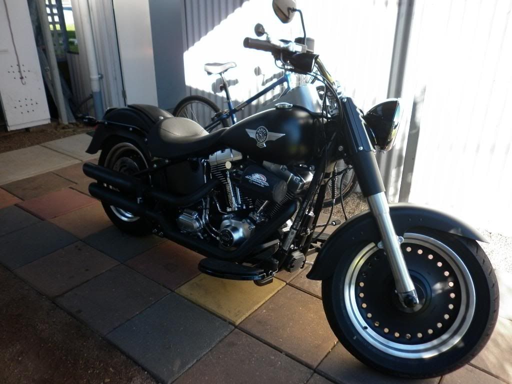

    Up for 8000 k service soon going to get se 254e cams put at same time bike should go well with super tuner heavy breather and d&d low cat pipes.

    Well i got cams in bike goes alot better next is put low cat pipes on the guy at frasers said if i put them on without going into ecm and turn off the exhsurst valve it will through a light does that matter i have the cables and software but not the confidence do i have to go in turn it off and reflash or just go in and turn off any comment from those who know would be great thanks.
  • Ando
    Ando
    Mate if you know which Cal you have in now with it saved all you need to do is load a Cal in that allows you to turn of the exhaust flapper. then reload the Cal you have set up for the Cams you have
    piece of piss really
