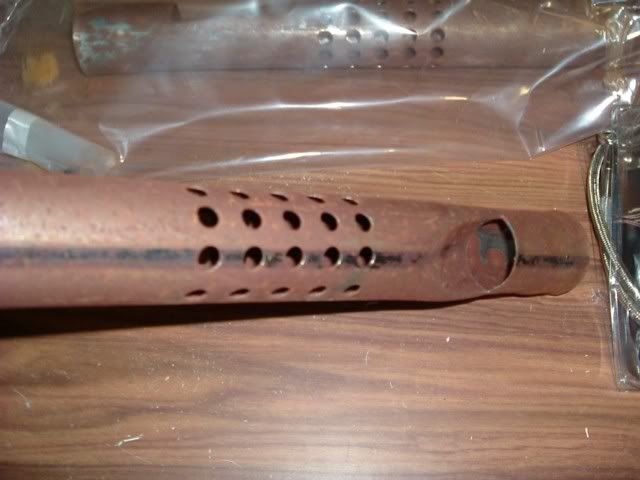

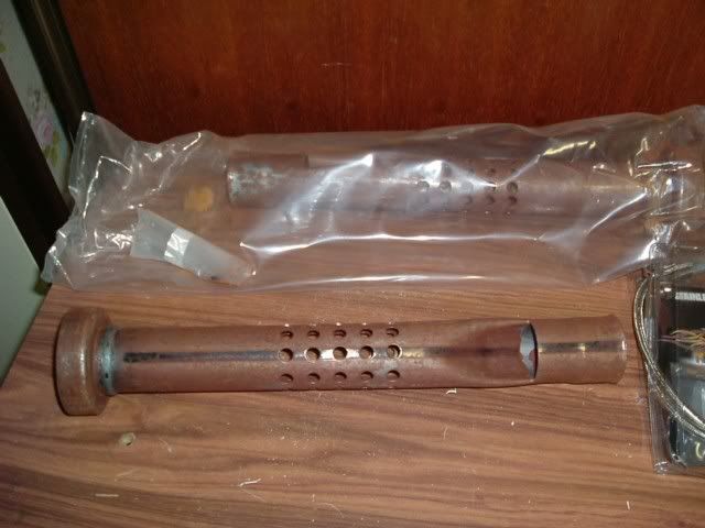

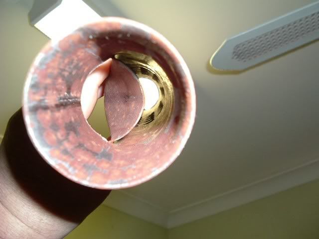

    The new replacment baffles have arrived today
    they are both of the same diameter and unpainted, and have 5 row of 10 holes (50 all up ) but the most important, they have the front ramp open, I am including photos
    the open front ramp

    I'm going to modify my standard ones the same, thanks for the pics...
