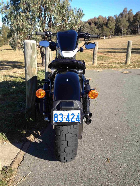

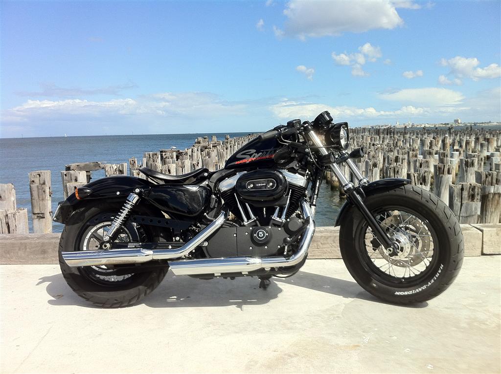

  • maachine
    maachine
    Here are some pics.... The pipes are a fairly new addition as well, Bassani Firesweep, awesome sound and quality.....got em from Walka at VPW.  Wouldn't mind tryin' out a different seat, maybe a LePera Bare Bones.....I don't think moddin' a Harley is ever a done deal, part of the enjoyment of owning one.

  • terroristone
    terroristone
    thanks for the pictures mate, i have the lepera barebones seat and love it, i have been looking into a springer seat......
    With the front shockers, it looks to be the same height off the ground or is it just the pictures, Whats the difference in parts (length)??? are the lower fork sliders shorter ??
    T1
  • maachine
    maachine
    No worries man. The original 48 dampers are 175mm and the Dyna dampers are 250mm. Even though there is a 75mm difference in the dampers I reckon the height of the forks is about 50mm extra. Not really noticeable to look at but very noticeable in rideability, much better ride, I am sure the Progressive springs have alot to do with it as well.

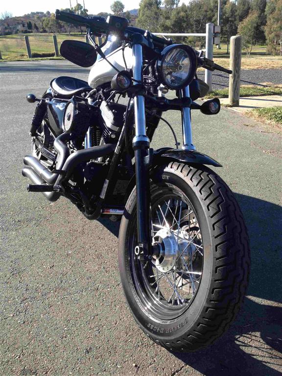

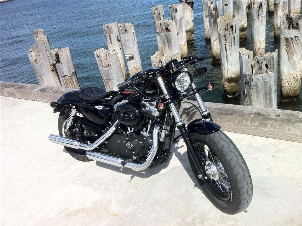

  • Viob
    Viob
     Hi guys,
    Just wanted to add my latest upgrades and first riding impression to this thread. With help from T1 we upgraded my '11 48 yesterday including Oldman Conversion, drag bars, XR caliper and braided lines. See the final product below. A couple weeks back I also fitted the HD solo springer seat but turned it into a non-springer seat because the position was too high and too far forward for my taste and leg length (190cm).
    First impressions with the oldman setup. Bike feels much more firm and stabile. The stock setting always made a weird metal 'click' when riding on an uneven surface and when reaching the max travel length. With the new springs I tried to run over each and every manhole cover I found. No weird sounds anymore and it now feels like a real bike. No heart attacks anymore when riding on bad roads.
    In addition to that I can really recommend the XR caliper upgrade. T1 found my break pads were already quite worn down after only 6500km. So maybe it's my riding style which I would see as a good fit for our bikes called Sportster <img src=" /> accelerate, break hard, corner, accelerate... In any case the callipers in combination with the new fork setup work really well! Two fingers breaking is now possible on a HD.
    Let's see how the springs settle in over the next few hundred km.
    The setup btw is pretty much stock. T1 used the standard length for the spacers. For a comparison my weight is about 85kg. Oil was Screaming Eagle fork oil.
    Maybe this thread helps to convince some others who think about doing this conversion as well.
