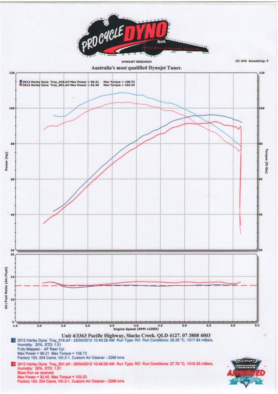

    Mate for what it's worth I have a mate with a dyna with 254e's in his 96, goes fine, he has air done and V&H short shots, I'm impressed with the power they generate, but they have a really short duration. Have another mate with the 259e's in his Road King, with work done to his heads and air cleaner and V&H long pipes pulls hard and comes on strong. The 259's are a high lift version of the 211's. I would go the 259e's if it was my choice if you're not increasing your compression.

    Hers an idea on how the 254E cams go in a 103 ci all iv done is a AF, 2-1 V&H pipes and SERT.
