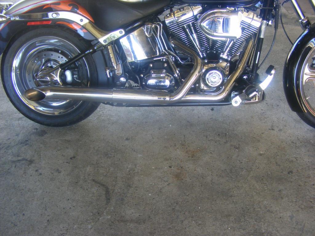

    Bad I was thinking like you and didn't bother with another test, I realized my problem was with tuning on the 2:2's.
    My compression tester is the screw in type.
    I re installed the 2:1 RB Racing pipe and the map I had tuned for it and all is well again. I just cut the worn tail piece off and welded a modified HD touring turn out muffler on, minus the baffle of course. The weld is behind the chrome collector heat shield.
    I was going to get the 2:1 tail pipe rechromed but it's possibly cheaper to buy a new pipe in the future. I might even get it powder coated black, dunno.
    Thanks again blokes your coments are much appreciated.
    Bluey

    If it's looks your after you wouldn't buy an RB Racing pipe, saying that if you are after performance you cannot go past them.
    Here is a link to RBR's web site, lots of good info on exhaust design.
    http://www.rbracing-rsr.com/exhausttech.htm
    They design pipes for performance and do a great job. We have quite a few different 2:1 pipes on various HD's and I get lots of comments mine sound good. They definitely smooth out the ride and produce more low and mid power.
    On a recent trip to Cooktown I got a respectable 21.5 kls to the litre riding in a group (third from front, that makes a difference). I calculated it over three consecutive fill-ups. It doesn't run hot and gets good mileage if you don't twist it.
