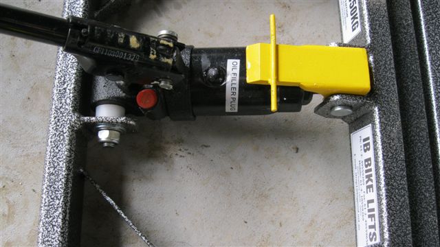

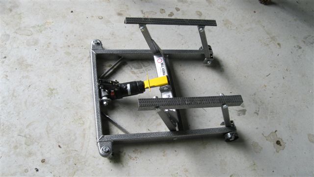

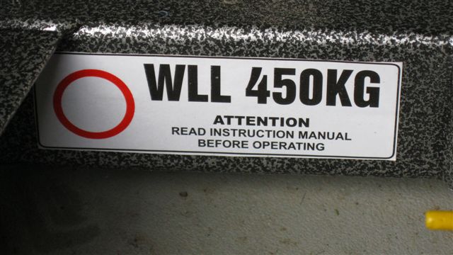

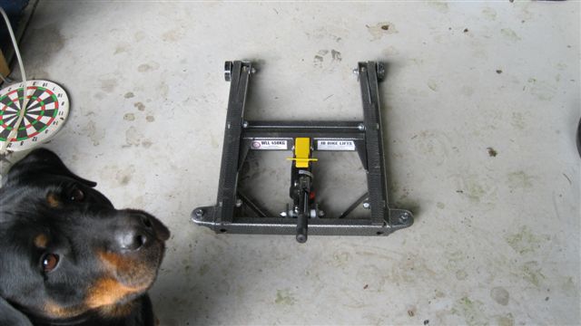

     Ok review time, I used it in the Afternoon to give Candy some Bike Husbandry,
     Construction is very robust, finished in a nice hammer tone paint.
     First time I placed the Lifter under I didn't have the balance correct, so the front wheel didn't leave the ground.
     Lowered then tried again, balance correct, I couldn't believe how easy it was to raise the bike off the ground and engage the jack lock.
    Gave it a bit of a shake on the Lifter, not to much mind you, but enough so if I was to bump it. Solid as a rock.
    Gave Candy a Clean and Polish, Even gave the tires a good going over.
    Wasn't to sure how I'd go when lowering the Lifter, first check make sure the side stands down and the wheels turned to the left.
    Had to disengage the jack lock first, then lowered bike slowly to ground.
    I was holding on to the handlebars for dear life, just in case, not a problem controlled the lowering speed via the control screw.
    She went down smoothly hassle free.
    Removed jack with a smile on my dial.
    Construction 9/10
    Ease of use 9/10
    Price 8/10
    There are cheaper units available, so as there are cheaper motorcycles available.
    But I like how this ones made and the ease of using it.
