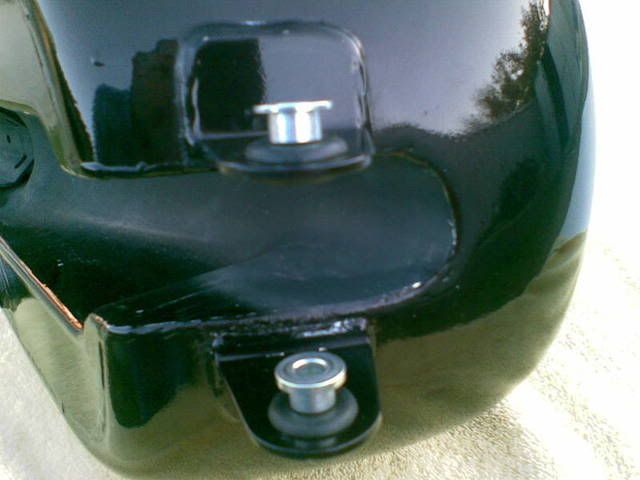

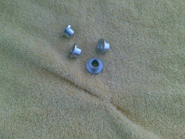

    Which way do I put these bloody sleeves in the lugs to my new tank.
    I have bought a bigger tank and this one has rubber mounts. After looking at it now I was struck with Arrggh what side do the sleeves go. I have 4 of them and wonder do they go in with the flange side to the outerside or the innerside of the tank lugs ?
    I added the pics to help  if it does hehe

    Yes Scotty they are 2 different thickness flanges/shoulders. I assumed there are 4 as there are 4 mounting lugs and 4 rubbers 2 in the front and 2 at the back.So the mounting bolts will go through the lugs through the frame and the secured with a nut as supplied. All this came in a box when I bought it unpainted.
    The bike is a 92 sportster I am replacing a 2,25gl tank with an aftermartket 3.3gl tank I think thats the size anyway. then once thats on all thats left is to get my seat picked up from the upholsterers and finally get my ass out for a ride. This has taken way longer than I thought to have completed.

    i still cant see the reason for having different thickness shoulders as they wont and cant be used as a spacer kind of thing.

    Hi, they all go on the inside, thick ones on the front with the longer bolt and 2 washers. Thin ones on rear underside with shorter bolt and 2 washers.

    Thanks MAtt and Scotty
    Got it now.
