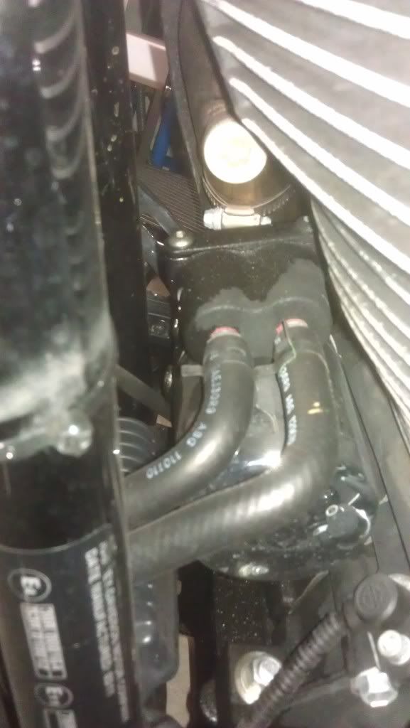

    I had my ex, Vulcan 900, for 5 years and not a single little drop, my Road King 2011, not even 10mths old and its at the second leak already.
    first was at the oil cooler, somewhere, now is above the oil filter, I am not sure if there is an oil pump in there or not, I guess I will take it to the dealer to have it fixed anyway.
    i am just annoyed about the inconvenience....

    im just trying to work out from the picture where it may be leaking oil ...... you checked that its oil and not something like steering head grease ???

     degrease it then ride it to see where its leaking from.

    I would say its something to do with the adaptor plate for oil cooler, probably a pinched O ring or not torqued up correctly nothing major
