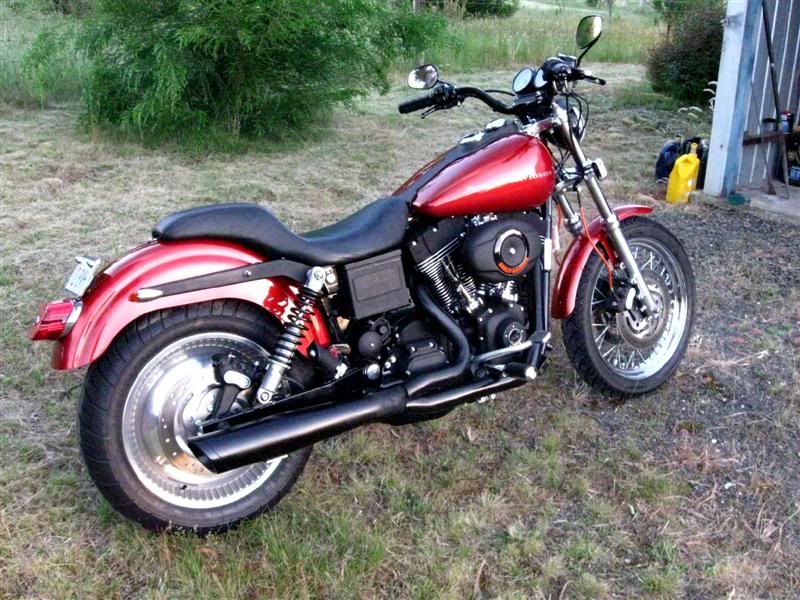

     Here are some photos of the Bub product...
  • mikedsilva
    mikedsilva
    As for the sound, it is great. Not offensively loud and I do prefer the sound of the 2 into 1.
    Performance is not good at the moment. I am running a fuepak and they dont have a tune for a BUB, but they do have maps for V&H Competition 2into1, and also Thunderheaders... Every map I run, the bike has a huge weak spot low in the rpm range.. then as the revs pick up, it climbs out of the hole and runs till redline. I don't have a tacho so dont know the rpm at which it clears up. I cannot see that it was something I did wrong in the installation...

     yeah they seem pretty low hope they dont scrape first time out they look real neat though good luck
