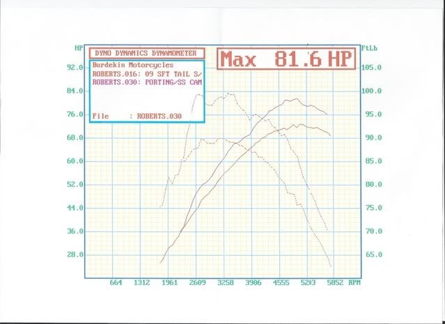

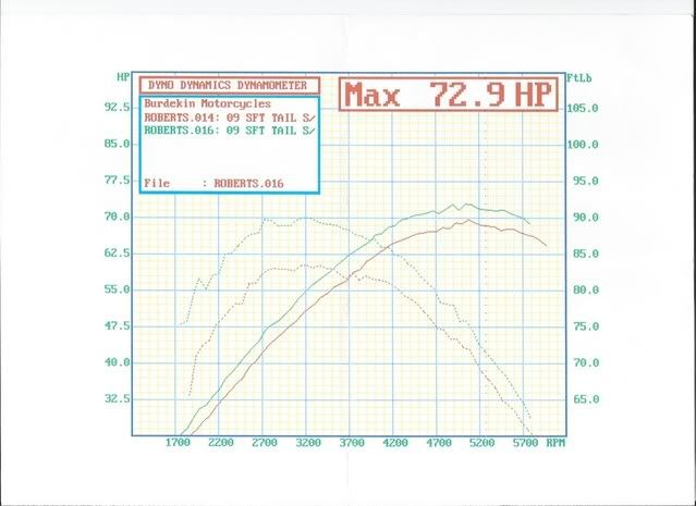

    Thought I would post some figures up on my recent mods on bike.
    2009 FXST with S & S slipons and screaming eagle air filter
    72.9HP Max at between 4700rpm and 5200rpm and 90NM torque
    Replaced slipons with D & D Lowcats 583 S & S easy start cams and heads ported
    81.6HP Max between 4555rpm and 5203rpm and 100NM torque
    Increase of over 10% which I am happy with.
    Both Dyno runs were done by same bloke on same Dyno, bike now pulls a lot harder.
    When I get a chance I will put up Dyno chart but wont be for a few weeks.
    Robbo

  • Robbo_Townsville
    Robbo_Townsville
    $2600

  • Robbo_Townsville
    Robbo_Townsville
    No. Happy with what i got.  Dynos differ from here to there, but I am happy with a genuine 10% increase.

  • Robbo_Townsville
    Robbo_Townsville
    Attached Dyno charts
