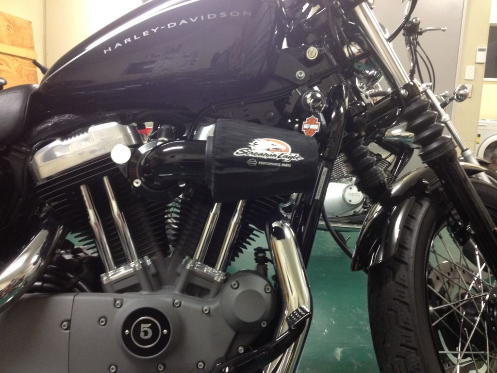

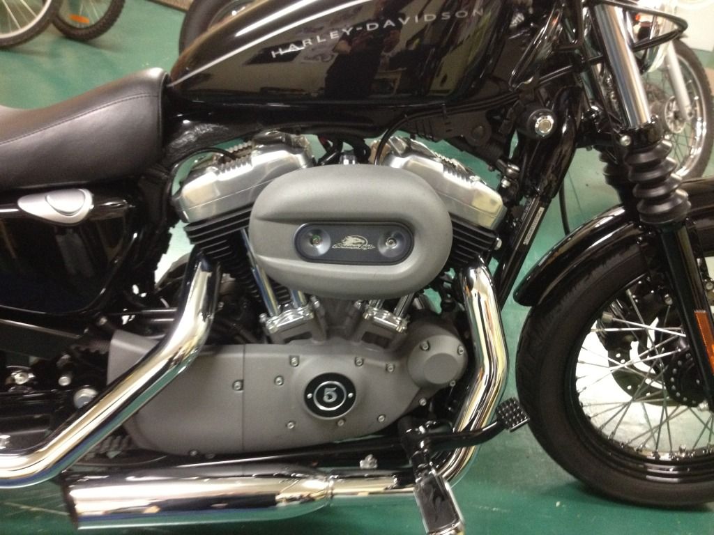

  • Freespaceage
    Freespaceage
     Just replaced my Screaming Eagle air cleaner with the heavy breather, raining at the moment so will have to wait for a test ride. Looks awesome though.............
    Before.....
    After............
