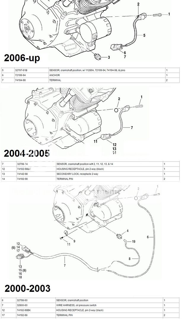

  • speedzter
    speedzter
    Crank position sensor?
  • speedzter
    speedzter
    The crank sensor should read about 1000 ohms if you have a multimeter.
  • speedzter
    speedzter
    Borrowed this from hdforums.com
    You want to unplug connector 6 and measure it there.
  • daddyracer56
    daddyracer56
     hi John i stuffed up Speedster would be right on the money ( crank sensor),    just put a new 1 in her would be best as she has done a lot of work,       i realy miss you on sat @ the races as i top  qualified  but did not get my by run as even number in the field 9 entered , 8 raced  bugger ,                             the Dyna ended-up doing a 10.055 sec pass @ 135.47 mph & i broke out on my dial in of 10.150 sec ,
