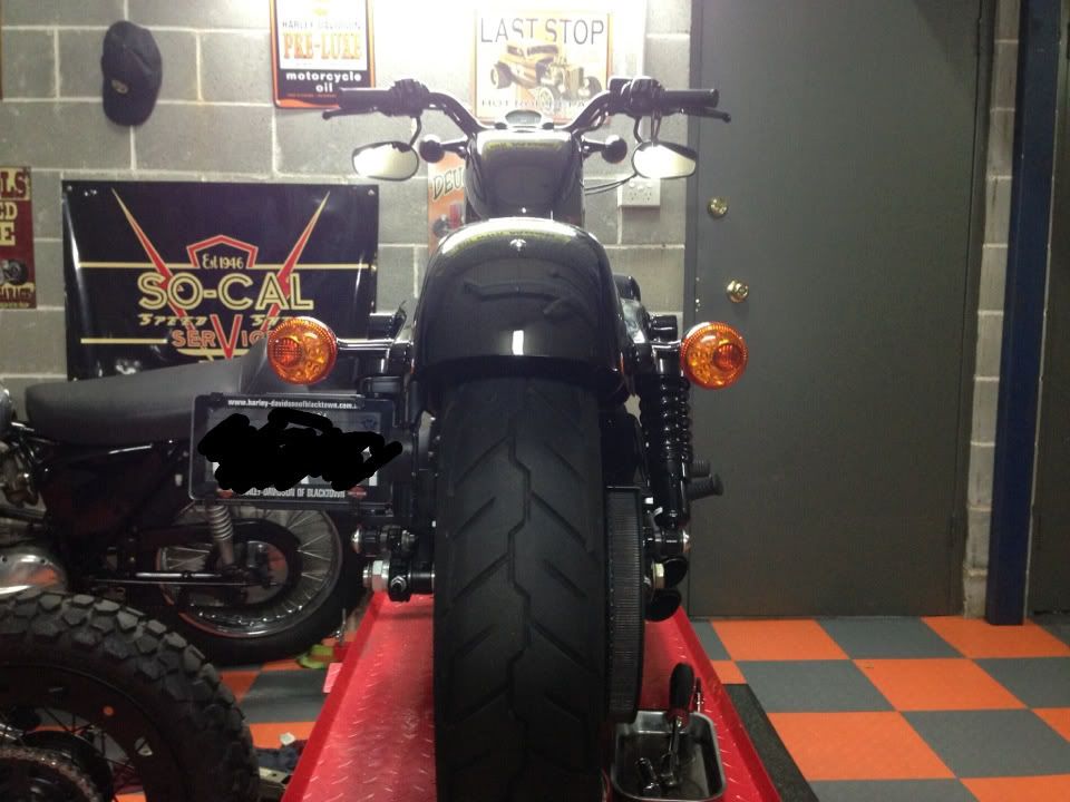

    I have cut about 25mm off my standoffs on my forty eight.
    Left is stock & right has been cut.
