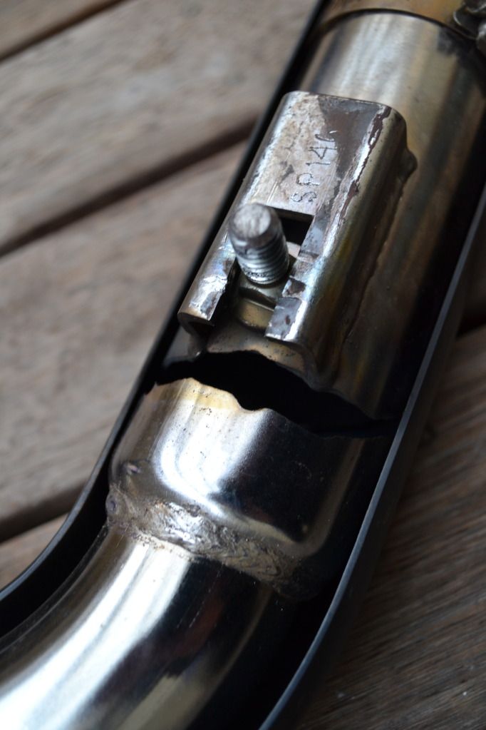

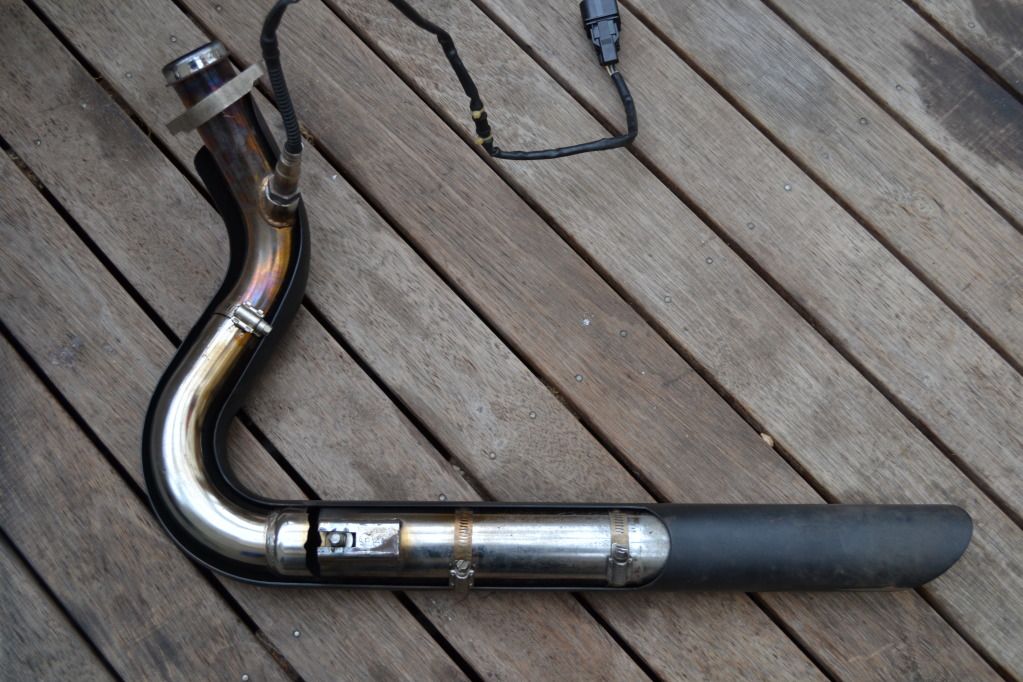

    I've had the Freedom Amendment pipes on my 48 for a bit over a year now. All good until a few days ago the bike develops a intermitent clattering sound. Took the pipes off and found this on the rear one.

    now that is not good at all. it looks like metal fatigue failure but why there? could have been at any other place near the mounting bracket weld. It looks like it is thick walled but hard to say. wonder just what material it is. in any case 1 year is not good
