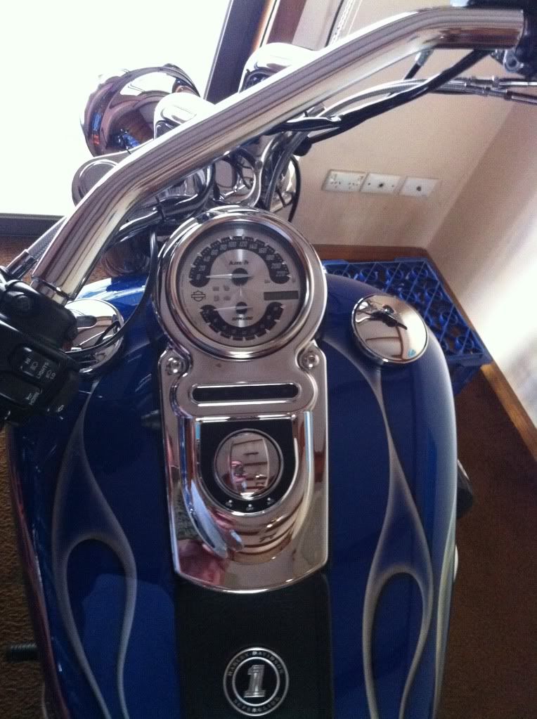

    Hi all.
    I'm in the process of importing an 07 wide glide from the states and need to find a kmph speedo for it.
    I'm not having mutch luck finding any info on the net, so can anyone tell me the p/n or size of the 07 speedo (ie 4 ,4 1/2 ,or 5 inch)
    I have the 2010 parts cat..... but all of the p/n's I have tried from there come up as discontinued lines.
    Any info appreciated,cheers WAZ!!
  • pat
    pat
    i put an 07  5" speedo/tach in my 08fxdc  and it worked , except 07s dont have a clock.
    has 67204-04c on it   is silver faced , low km
    good chance it will fit $120

    have a later one too ,the plug is the same
    09 and  later i think the kms eprom is in the computer not the speedo.
    got mine for $250 ebay.  ( peter $tevens wanted $830 what a rip ,probably better now as was 68cents exchange rate,  rrp usa $ 499 )  search  "  harley kph " " karley kilometers" and" harley metric"   got one for a mate  in black $230
    74719-07

    Strange fits 07 fxdc and 06 fxdwg
    Did 07 fxdc only have 5 speed?
    Oh well
  • pat
    pat
     200772197476 ebay 45 post
    Should be ok
    08 has clock.  You might be missing constant feed for it
    Only have 08 manual

    Have a look at the J&P web site, #560-904.
    They seem to have what you might want?
