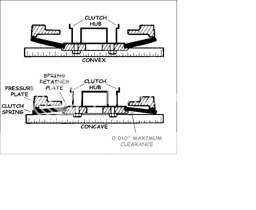

     h)  The adjuster plate has 3 sets of adjustment. A,B and C. A is the softest position, with the setting at A replace clutch pack and all clutch , once again be careful with the 4 bolts, criss-cross pattern and a couple of turns each at a time.(don’t locktite until you finish all adjustments.)
    Now check the spring setting with a straight edge. It should ideally be flat to .10 thou concave. This is measured at the centre of the straight edge. If  the measurement is out move the adjustment plate to B. Measure again and if still not right move to C.
    If C doesn’t do the trick you are looking at replacing the spring. Barnett offers a good replacement spring.

    Gday guys. Just an update. Finally got to check the adjuster plate and remove the clutch plates and they're buggered. All cracked and bits coming off so new plates it is. Just a question though with the three settings on the plate, A,B and C, I took a picture of the assembly before I took it apart but cant make out how I change the setting. The plate has a,b and c on it but how do I know which one it is? Are there any marks on the hub assembly that tell me or is it just the way the plate is mounted?

    have a look at what I posted before, h.) tells you how to set it up . One of the four bolts goes through A, B or C. A is the softest.
