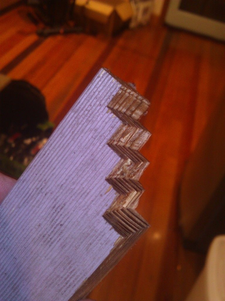

    I made my own primary lock out of a piece of wood.

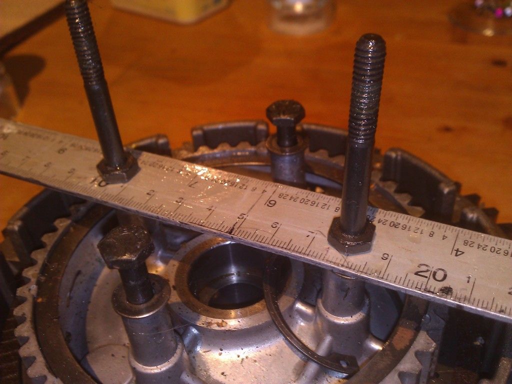

    To remove the clutch, I found a piece of steel on the side of the road, (25 x 10 x 1000mm with holes about 35mm apart) 2 years ago. I was able to put this over 2 of the holes on the clutch basket with a socket in between the gearbox shaft and the steel. cranked the bolts up in the clutch basket and with a couple of light taps with a mallet the clutch slid off.

    Ok imagine the ruler is a nice thick bit of bar with a hole drilled where each of the bolts is sitting. Place a socket between the underside of the bar and the spindle coming out of the gearbox. tighten the bolts up (ignore that the bolts are upside down, too many bourbons and they wont stand up the correct way) This will put pressure on the socket against the "mainshaft" I think its called. if its getting really hard to tighten the bolts give a couple of light taps with a mallet. Clutch should "pop" off the shaft.
    Worked for me and keep in mind I had no idea what I was doing.
