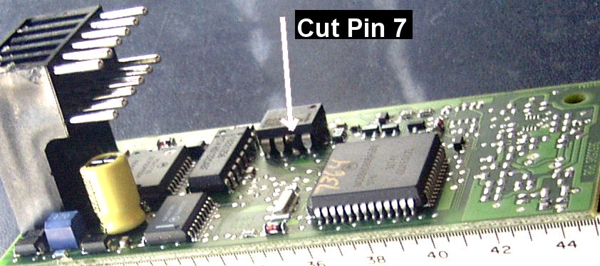

    Had a look around but good you fixed it but i came across this if your interested;
    The bank angle sensor is an 8-pin accelerometer integrated circuit inside the TSM/TSSM, not a mechanical or mercury switch. It outputs an analog voltage (0 to 5 volts) depending on the direction and angle of lean. I've modified mine to disable the sensor because it kills the engine when turning hard (racing) with a sidecar. This photo shows the TSM, and part of the mod I did.
    http://www.hogwildracing.com/technical/TSM_Board_Top_cut_pin_7.jpg
