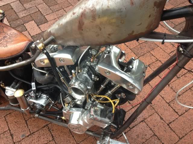

    Anbody familer with this set up & Tuning.
    Having issues starting cold & warm - ( I have roller starters so no issues bring motor up to speed and starting on these ).
  • houli
    houli
    Lots of variables,is it stock or a stroker or bigbore, compression-too much / too little, cam?, straight out exhaust?, timing,plug heat range,leads, etc, but looking at your carb i`d say that is the problem, replace it with a stock cv and aircleaner and get the bike starting and running well this will give you confidence in what you have, then put the big carb back on, ask around and see what jets others use for the same setup as you.
  • bobberash
    bobberash
    Thanks Houli,
    It a fresh rebuild a little on the wild side i got the cases and whent from there, It only got about 10 km on the motor. It will randomly start when its warm sometime with the choke on sometime's with out , its just pure random . And no way will it start when the motors cold with out the roller starters

    I have just put in decompression plates aswith the comression releases on its to light to kick and they "pop" after one kick.
