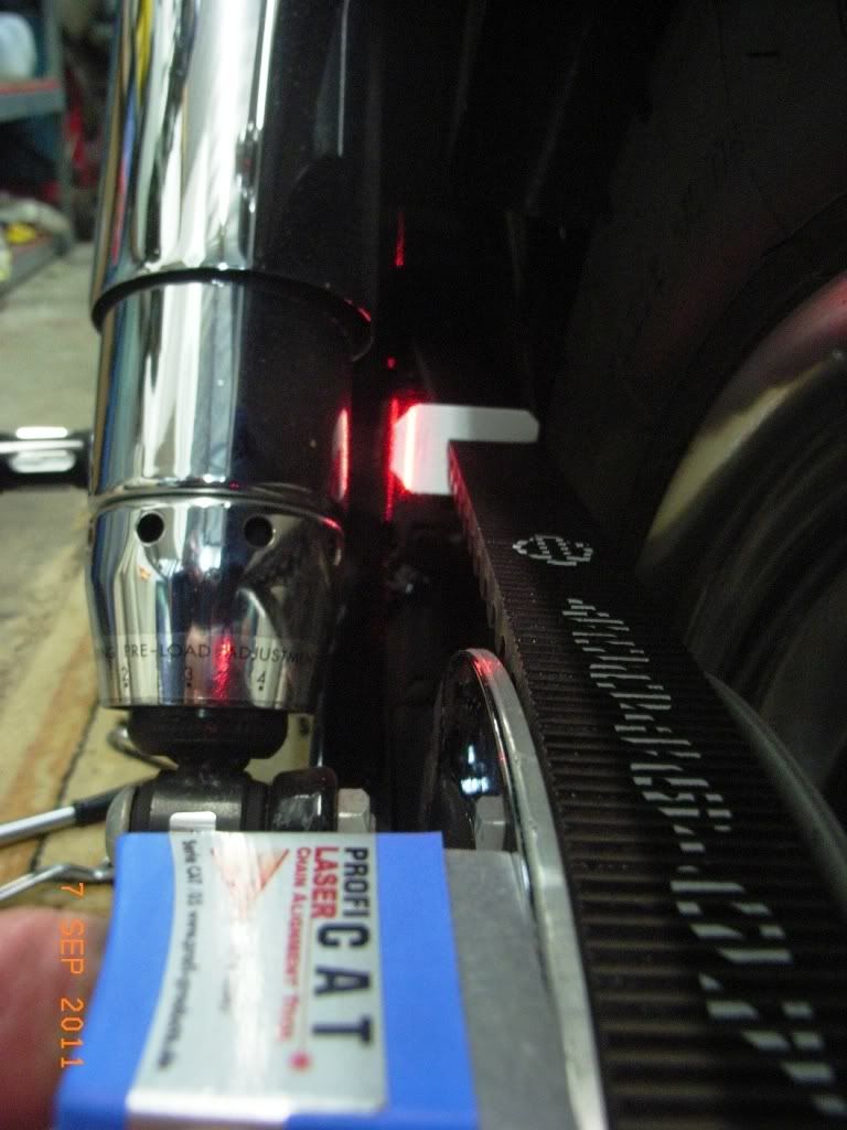

    Here you go.  This is on my Fatbob, although I have used it on my wifes sportster.  I take off the chain guard and use the top run of the belt.  The indicator slides over the belt and enables you to check alignment from the rear sprocket almost all the way to the front one.  If its out of alignment , it wont keep the laser on the same mark as the belt goes forward.  A bit of mucking around, but seems to work very well.

    I just used one of the laser levels from BigW - I think it cost me 8 bucks thought they're usually about 12 I think.

    http://www.hdforums.com.au/Default.aspx?tabid=71&view=topic&postid=178146
    I did the axle plugs and rod trick a while back.  Thought I had it pretty damn good, until I used the laser one and found out how far out I acutally was.  All depends on how much you want to spend, how accurate you want to get it, if you can be bothered rooting about.
