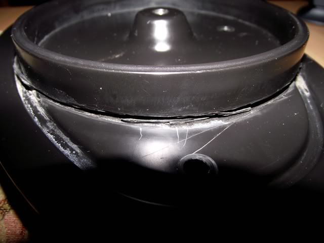

    Well I cleaned the filter tonight ans looky here it is starting to fall apart.  I have contacted K&N and asked about warrenty claim  and attached this picture.  That ring part holds the air cleaner cover on, so when that goes no cover.
    Any way a lot of crap came out of the filter, so will see how it goes,  Also Oz these are new Sensors in the bike. Only put themn in late last year,
    Any way I cleared the AFR and might do a V Tunbe in the morning and see what comes of it.  As has been said I left mine for about 30K and that is way to long in my mind.  Yep K&N Website says 50K miles about 80K before it should need servicing.

    Got an email from K&N they are sending a replacement filter. Happy with that..
