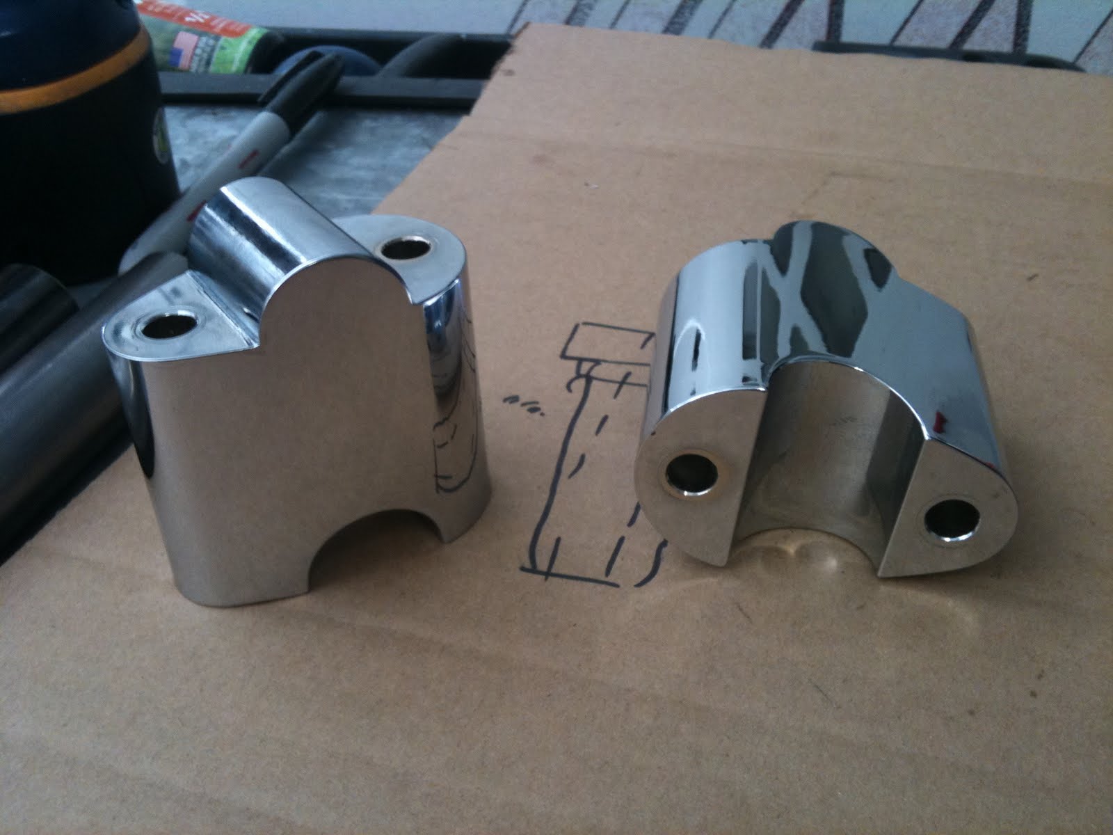

    July 11 , 2011 " Risers for Street Bob Harleys "
     American made parts are hard to beat. Most of us pounding out parts are doing it because we just love to make stuff. The money sure helps but if your like me , you make stuff even when you don't make money. Just because your good doesn't mean you'll be making any money . Seems we all need a touch of luck to keep everything running smoothly  . I sort of feel i am in the first group. I GOT NO LUCK !.
    Still waiting for the phone to ring . One of these days ! .
    Lately i have been making more handlebars . You think , they bolt on and we don't give it much thought. BUT ! No way , every time we get things figured out, someone comes along and changes things up and creates new problems and new solutions .
    What I am getting at is most bars bolt up to a riser mounted on the top tripple tree with 3 1/2" center bolt pattern. Unless you have a springer.  With the introduction of the H-D Street Bob , harley decided there top tree had to be different from every other model. There idea was to machine  the risers right into the top tree. This kind of limits the bars you can mount . Especially if you want to move up to 1 1/4" dia. tube handlebars . Some of you are content to use the stock bars. For those of you that want a solution to the issue , there is a machine shop in my area that has not only redesigned a riser to bolt directly to the stock top tripple tree, but he has a line of top tripple tree's that are designed to replace the stock top tree with a  traditional top tree. These are cnc machined and first quality. The risers are 2 " model pictured. These are available from 1 " to 6" . They are priced reasonable and can be purchased through me . Like all my parts , these fine parts are made in the USA .  If you have questions , you can call me personally at john 360-750-6780 .
    Hardtail Choppers will continue to bring you new and innovative parts and services . Tell your friends about us . Remember , "if your coastin , your goin down hill " jg
