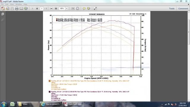

    Hi guys had my biked dyno tuned today.
    Results
    first run at 1 30pm
    max power 66.63 max torgue 82.95
    second run at 2 08pm
    max power 73.00 max torque
    Iam running S&S slipons and SE Stage 1 air and SERT
    My questions
    1. it looks like they only spent around 30 odd mins to dyno the bike?? would this be normal ??
    2.how do you tell how manys runs they did ?
    3. how do you think the number look after the tune ?
    NOW MY MAJOR ISSUE
    Whilst the bike feels strong, as soon as you back of the throttle it decels (every time) when changing gears about 50% of the time its backfiring ? sitting on 60kph for a period can feel it surging a bit .. once home whilst idiling and giving it a quick rev it missed fired or back fire... then on 2nd rev was ok.... so guys what do you think ?? IAM NOT HAPPY this was the 2nd time in for dyno tune last time machine not working NOW this ?? plus I spoke the tuner this morning told him I did not want any decel or backing firing ??
    ps was done at Harley Heaven ?

    I agree with Ando that they loaded a canned map and done some fine tuning to the map. A good tuner will build a new map for the bike taking 6 to 8 hours on each bike. The charge is normally between $500 to $600. Nothing wrong with running a canned tuned map with most stg1 bikes as there close to whats on the bike. Hot builds require more time on the dyno bringing everything in line and then you have the oddball type builds that require more pulls to get a good tune. What would piss me off is if they charged you the full price for a canned map with half hour on the dyno. ?

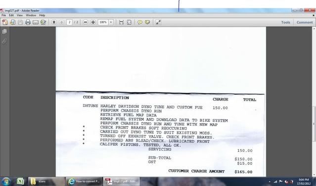

    I think you guys are right the invoice says " Harley Davidson dyno tune and Custom fuel performance and chassis dyno run"
    When I purchased the bike was offered a dyno tune for $165.00 throw in with the deal to be used at the 1st service (then I heard from sum guys at the service desk that were offered same deal as introductory offer as they have not had the dyno machine very long).
    I will back there in the moring to give them a blast over this as I concider this to be a complete misrepresentation on what I was offered at the time of purchasing my new bike. I will be demanding that they do a proper dyno tune on my bike as to what I was offered at the time of purchasing. If they fail to do this I will take it up with the department of consumer affairs.

    You will never get much of a Dyno tune for $165.
    A decent tune would normally cost $500, or more.

    Firstly, the $165 for the dyno was offered to me at the time of purchasing my new bike, it was offered as part of the deal to buy a new bike (however I have since heard that this is a new dyno machine and they have been offering it to everybody for this price.  Apparently it is ending shortly) it does not matter what the cost of the dyno tune would have been as I was happy to pay any price within reason.  The bottom line is I was offered a dyno tune!  Nobody told said to me that it would be a watered down tune just using a canned map and a couple of runs on the dyno... My belief has always been to dyno a bike correctly you need to do it from scratch.
    If the steeler/salesman had been honest with me and told me the truth about the dyno not being a full dyno (it was also the salesman who made the suggestions to me about what type of slipons,SE stage air,SERT tunner to use)  I would have declined their offer and went to somebody else who did the job correctly.

    Hi phqasit , noticed on the invoice you posted , soft front brakes . I have a 2012 abs Superglide , and am having problems with front brake. The lever , over time , keeps coming closer to the bar . Dealer bled front system and was rock hard with minimal travel for a brief period , but now lever is creeping closer to bar again. Service manager said I wasn,t alone . I,m in Adelaide.
  • phsgasit
    phsgasit
    TIM SG
    THIS IS MY POINT... this is the 3rd time i have had my bike back re soft front brakes... instead of fixing it the first time !!! they just keep mucking you around... my thought is they take on too much work each day and cannot handle their work load, so the keep putting of there warranty work.. however i think they are playing with peoples lives re brakes so they stupid..
